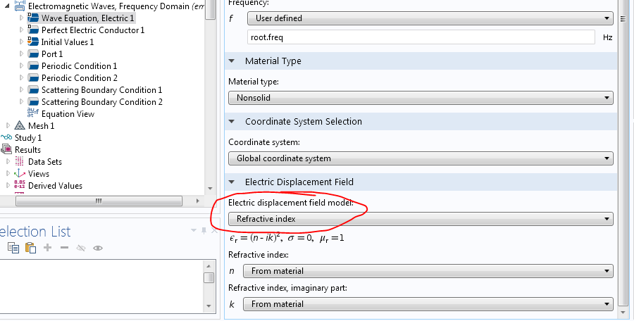

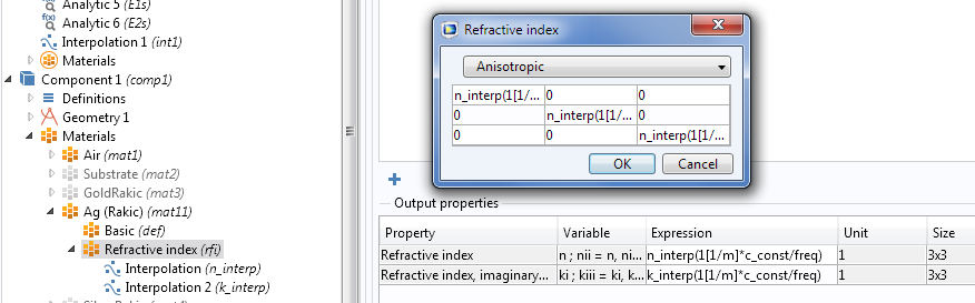

Posted: 10 years ago Dec 10, 2015, 2:04 p.m. EST
The simple way to define anisotropic refractive index is to use the comsol interface, please take a look at the attachment.

Maxim Electromobility
Posted: 10 years ago Dec 15, 2015, 5:53 a.m. EST
Hi Mahmood,
The screenshot is from RF module, Wave Optics and Ray Optics modules work in the same way.
You might also want to define the anisotropic materials in the local coordinates, as Ivar have mentioned in one of the parallel discussion, if your anisotropy axes do not coincide with the global axes.
Best regards,
Maxim
Hi Mahmood, The screenshot is from RF module, Wave Optics and Ray Optics modules work in the same way. You might also want to define the anisotropic materials in the local coordinates, as Ivar have mentioned in one of the parallel discussion, if your anisotropy axes do not coincide with the global axes. Best regards, Maxim

Posted: 9 years ago Sep 18, 2016, 8:05 p.m. EDT
Hi Maxim,
Thanks for posting this, it's exactly what I need. I'm trying to do this in the material properties but for some reason my version (5.2a) only shows options for isotropic and diagonal, not anisotropic. Did you select any special options to get the aniosotropic option up?
Cheers
Hi Maxim, Thanks for posting this, it's exactly what I need. I'm trying to do this in the material properties but for some reason my version (5.2a) only shows options for isotropic and diagonal, not anisotropic. Did you select any special options to get the aniosotropic option up? Cheers
