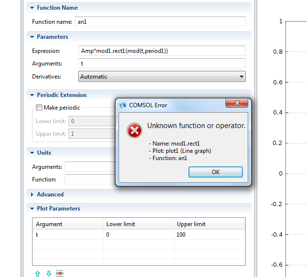

Ok, so I defined the parameters, Amp and period1 in the parameters menu. When I try to plot the an1, it gives me an error "unknown function or operator" mod1.rect1.
I attached a picture of the error if you want to take a look.
Thanks again for helping!
Hope that it will work now.
Barend
That you velocity have a particular value of t=1 till t=3 in a period and for the rest the inlet velocity is 0.
Or do you want a wavelike kind of inlet velocity?
That will make it perhaps easier to help you.
