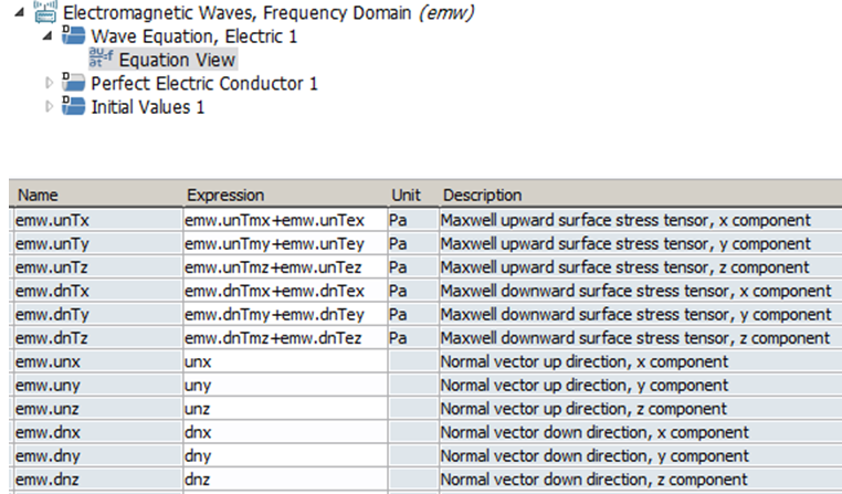

Variable emw.unTx corresponds to Maxwell upward surface stress tensor and is calculated using normal vector up direction emw.unx.
Variable emw.dnTx corresponds to Maxwell downward surface stress tensor and is calculated using normal vector down direction emw.dnx.
These variables are defined under Equation view, as shown in the attached image. To visualize the directions of the normal vector up or down, create line plot of the corresponding vector components
For particle surrounded by air, use upward surface stress tensor components to calculate force on the particle.
If you want to calculate force on the air interface, use downward stress tensor.
Sergei

Thanks, I have found the equation view.
My model is a dielectric sphere between the nanoparticle(Au material) and the nanorod(also Au material).
I want to calculate the force exerted on the dielectric sphere.
According to your suggestion, I should use the upward surface stress tensor components .But the results were 0(x,y and z component ).
If I use the downward stress tensor, I get the non-zero results.
Why ?It puzzled me.
