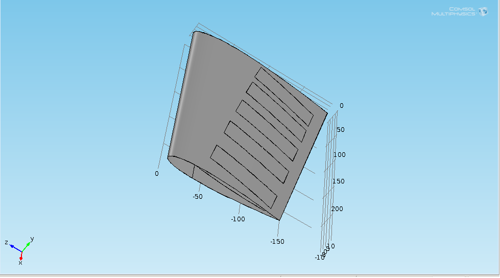

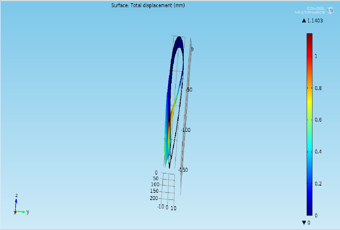

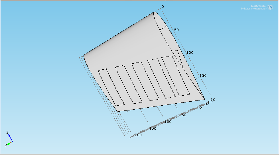

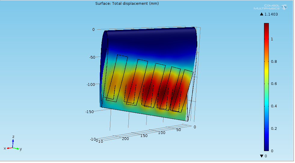

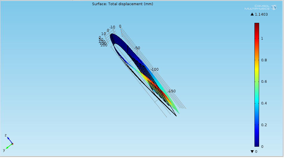

I uploaded test.zip file.
In test.mph file, there are two Models. One is the moving mesh and structural mechanics, another is heat transfer.
after solving the first model, i exported test.mphtxt using the procedure I mentioned before.
and then,
I imported it in the geometry section. you can find the geometry that is deformed.
thanks
and then,
thanks
