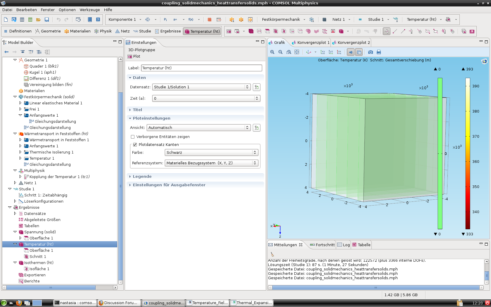

Posted: 1 decade ago Apr 28, 2015, 6:20 a.m. EDT
Hello everybody,
i have the same problem as above described. I want to model a coupling between strain and temperature distribution in a geothermal heat transfer where the fluid is injected through a sphere. My results are a bit confusing. I get a temperature distribution as implemented, but I get no strain distribution.
Attached you can find my model. Have I forgotten something? I can't understand the previous suggested solution.
In general I want to model thermoelastic processes. Is this the exact concept or thought at all?
Thank you and Cheers
Nastasja

Jeff Hiller COMSOL Employee
Posted: 1 decade ago Apr 28, 2015, 8:56 a.m. EDT
Hello Nastasja,
The screenshot you sent shows the GUI in German, which is fine but you may get more feedback on your work from other users of the Discussion Forum if you posted your mph file: this way other users would be able to switch the model to whatever language they prefer.

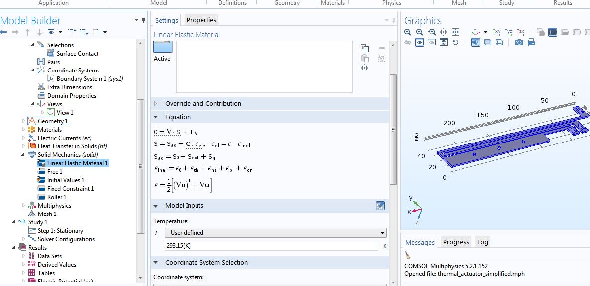

Walter Frei COMSOL Employee
Posted: 9 years ago Jul 12, 2016, 10:02 a.m. EDT
To address the original question, about adding thermal expansion using the core capabilities of COMSOL Multiphysics, please see this Application Example:
www.comsol.com/model/thermal-microactuator-simplified-16357
This example uses the physics interfaces from the base package of COMSOL Multiphysics, and then manipulates them using the Equation View feature.
Best Regards,

Posted: 9 years ago Jul 13, 2016, 9:48 p.m. EDT
Hi Walter,
I do not see any modified equation in "linear elastic material" section. it is just stationary equations. Am I missing something? By the way, I see "linear elastic material" kind of locked. what does it mean?
Best Regards,
Hi Walter, I do not see any modified equation in "linear elastic material" section. it is just stationary equations. Am I missing something? By the way, I see "linear elastic material" kind of locked. what does it mean? [QUOTE] Hello, To address the original question, about adding thermal expansion using the core capabilities of COMSOL Multiphysics, please see this Application Example: https://www.comsol.com/model/thermal-microactuator-simplified-16357 This example uses the physics interfaces from the base package of COMSOL Multiphysics, and then manipulates them using the Equation View feature. Best Regards, [/QUOTE]
Posted: 9 years ago Jul 14, 2016, 2:44 a.m. EDT
Hi Adnan,
You have to make Equation View visible.
A screenshot of how to do that can for example be found (just below the second animation) in
www.comsol.com/blogs/how-to-make-boundary-conditions-conditional-in-your-simulation/
The 'padlock' symbol which you see indicates that the equations in that node have been edited manually.
Henrik
