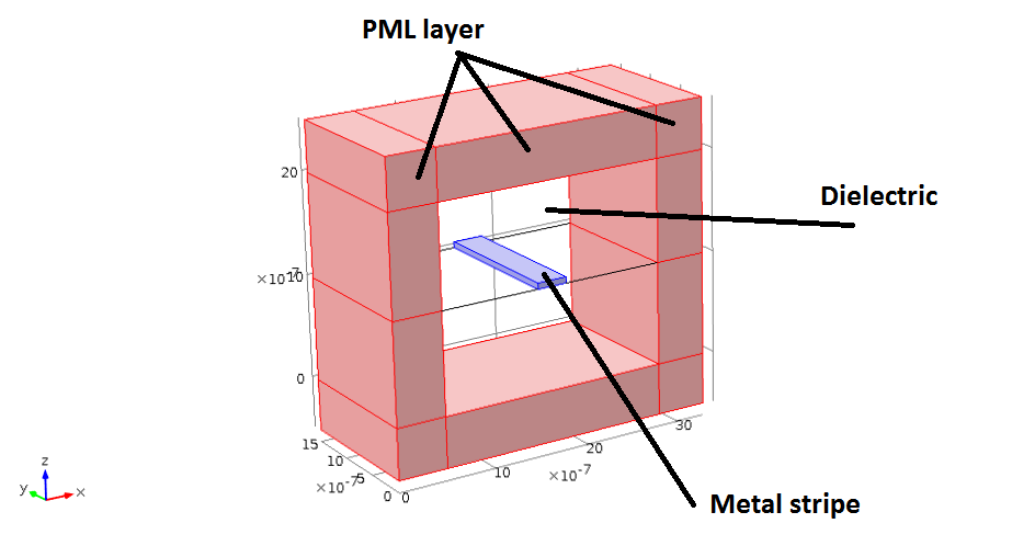

To do this I have created a simple 2-port structure - the metallic stripe embedded in homogeneous dielectric of 1um thickness from each side (see the attached picture, blue is the waveguide, red is PLM layer). The waveguide is terminated by 2 ports at each transverse cross cuts.

I would use two numeric ports (excitation and passive) and set two Boundary Mode Analysis steps (for each port) followed by Frequency Domain step. You might not need PMLs if dielectric domain is sufficiently large compared to width of metal strip.

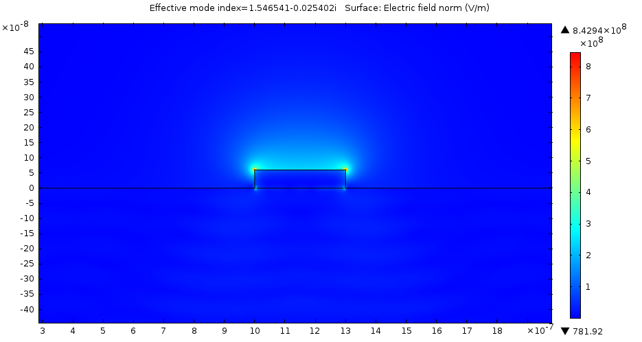

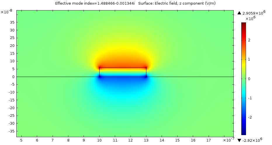

Yes, I've done exactly the same things for mode analysis. For example the picture A.png shows one of the modes of this waveguide (for this mode the top and bottom dielectrics are different). This is plot of emw.normEbm_1 for excitation port 1. Now I want to study the propagation of this mode not in transverse but also in longitudinal directions. To do this I am using the same model. I have specified port 1 as 'user defined', wave excitation 'on', Pin '1W', electric field Eo(0,0,1) V/m, propagation constant as was found from the mode analysis (picture A.png). After that I ran the simulation (Frequency Domain) at the same frequency freq=c_const/lam0 where lam0=632[nm].

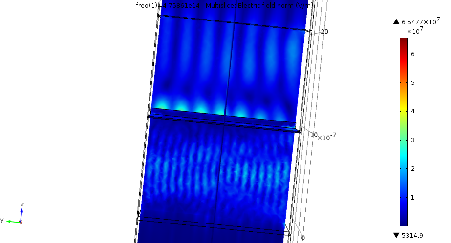

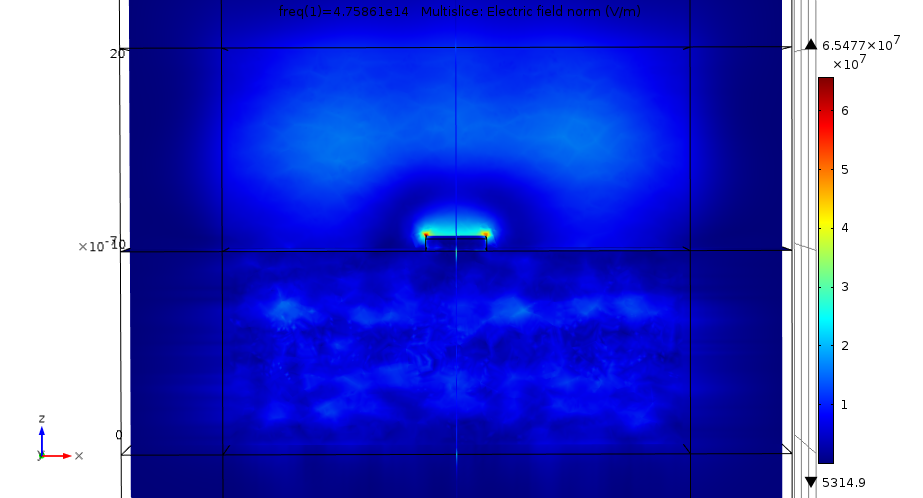

The results are shown on figures waveguide2 and waveguide3. Yes, my mode was excited as could be seen from transverse cross cut, but the wave also propagates through the top and bottom dielectric. But they shouldn't because I have specified the propagation constant for only one mode. What could cause such a result?

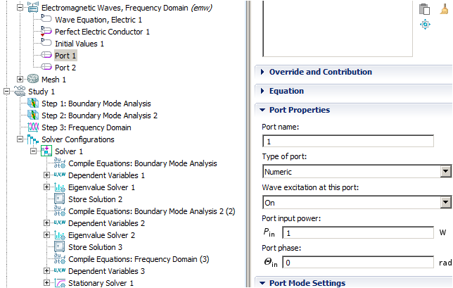

Not sure I understand how you can excite correct mode using “User defined” port. In my mind, “Numeric” type of port should be used to excite proper mode found by “Boundary Mode Analysis” step, as shown in the attached image. Some trial and error is usually required to set up correct transformation shift in the Boundary Mode Analysis step in order to excite desired mode.

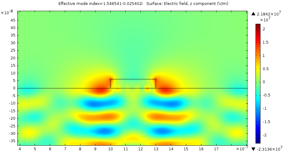

I have a last question. When I perform a mode analysis I receive a good mode electric field distribution for the waveguide embedded in homogeneous dielectric. But when I try to do the same with inhomogeneous claddings (the waveguide on silicon substrate with silica on the top) I still receive the mode profile but with "noise" (see the pictures) in dielectric with higher permittivity (silicon). How can I avoid such a "noise"??
I can see two possibilities:
1.Somehow you hit the radiating mode and solution is not a noise but radiating field (similar to microstrip antenna).
2. Solution is artifact caused by the presence of infinite silicon/silica interface. It is a challenging task to model infinite interface. If you are still using PMLs then solution is quite questionable, since PMLs are designed to perform properly if they enclose domain with homogeneous material (but not different materials). In this situation, I would enclose silicon and silica layers by air domain and study the effect of silicon and silica layer dimensions on the propagating mode. This might give insight on what is going on.
