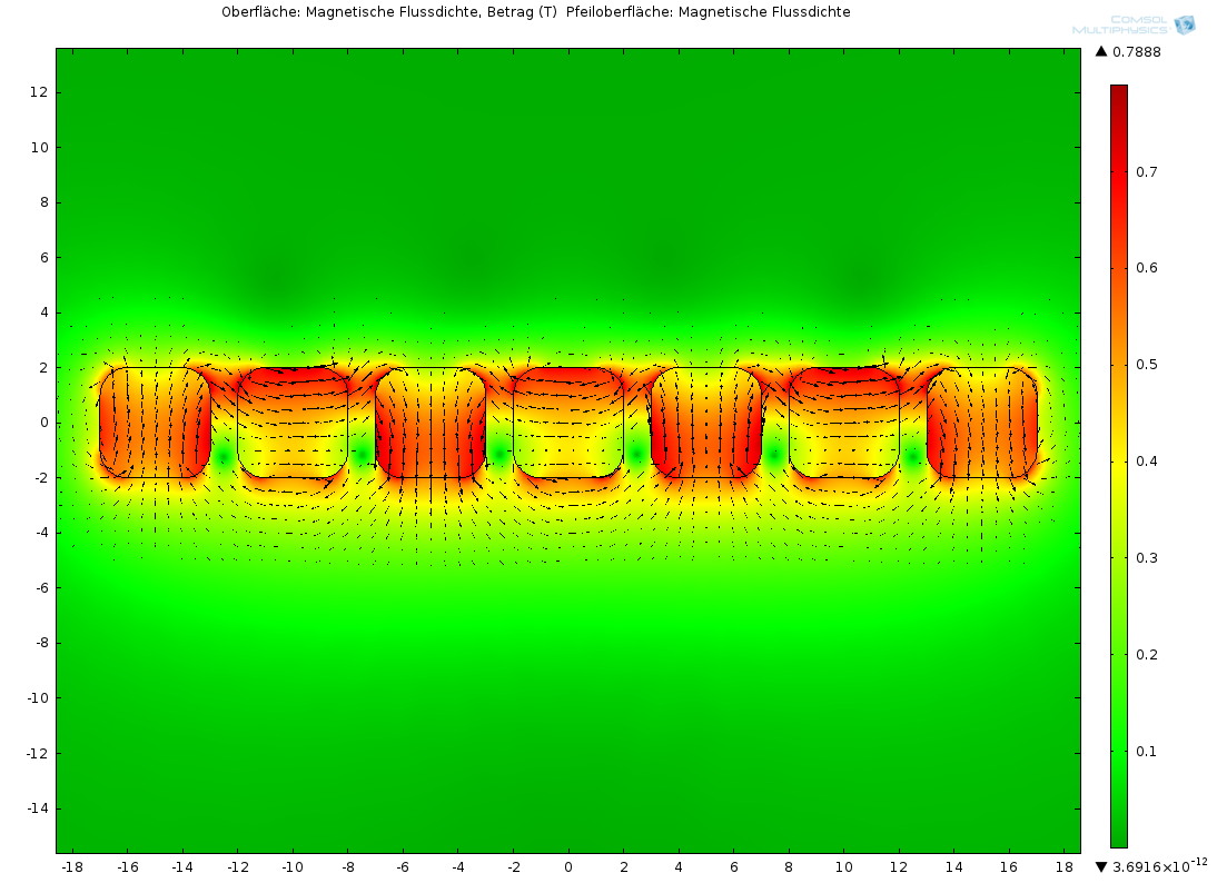

Plz let us know that And if i want to implement halbach for 7 pieces of 16 x 4 mm, how can i assign field lines into and out of the paper?
And let us confirm that while applying amperes law, I should divide 16 x 4 into two pieces and assign each piece say 5000 A/m in magnetization in x and y? Kindly confirm that. And also that how can I assign flux lines into and out of the paper (I mean by that field lines from top to bottom and bottom to top assigning)...
And what material should i assign? Iron or material like NdFeb etc???
Plz let me know that, it will be ur great favour...
Regards...
You can use my example for a Halbach array; this is in 2D.
So I don't know, what do you mean with "flux lines in and out of the paper"...
In 2D this is not possible.
Ralf

I use remanent flux density; rotating direction from piece to piece:
first piece: +1.2T in y direction, second piece: +1.2T in x direction, third piece: -1.2T in y direction and fourth piece: -1.2T in x direction and so on...
Other properties are sigma=1S/m and epsilon_r=1.
Ralf
I have attached the image below, I assigned remenant flux in accordance to ur instructions.
And let me know last few queries, these might be basic but new for me, so plz let me know that is there something like geometry dependency like I should Flux for circular or curved shape geometries and for straight or rectangular parts, I should use AIR medium and what should be the value of Tesla?
And is cube or cylinder formation is necessary around geometry/magnets to check magnetic field with its medium as air?
