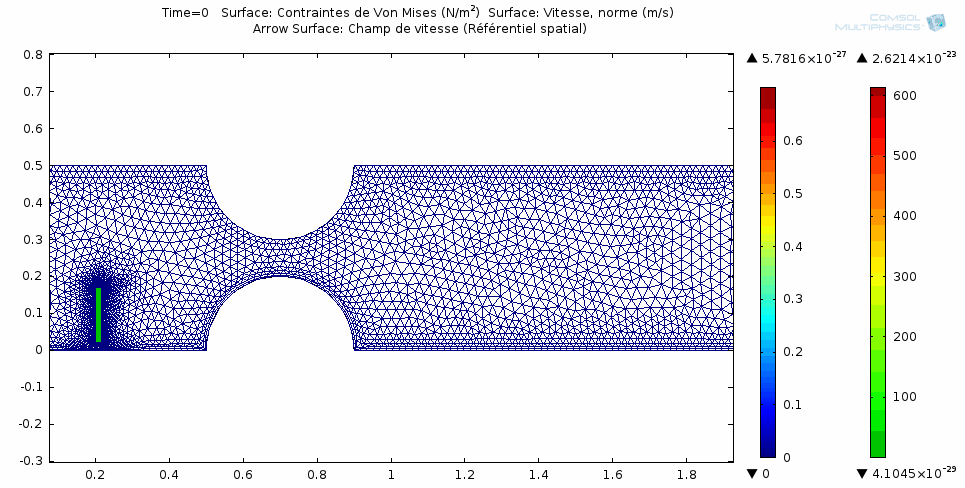

                                                    Hi everyone,
I'm trying to simulate a rotating object inclined in a laminar flow with the FSI physics. I managed to rotate an object with a body load, but it causes a lot of remeshing.
The rotating machinery physics deals with this problem by using a rotating mesh and a flow continuity boundary condition between the stationary and the rotating domain. I tried the same in the FSI physics but the continuity boundary condition produces "failed to evaluate... k_stress_tensor_testYX ".
Thanks for your help!
Moritz
