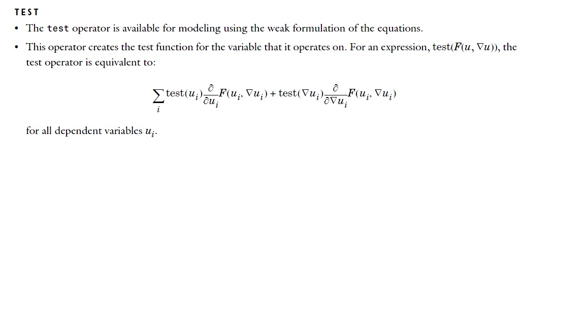

Posted: 1 decade ago Jun 11, 2015, 5:48 p.m. EDT
In the attached image is the answer for the test function. hope helps
