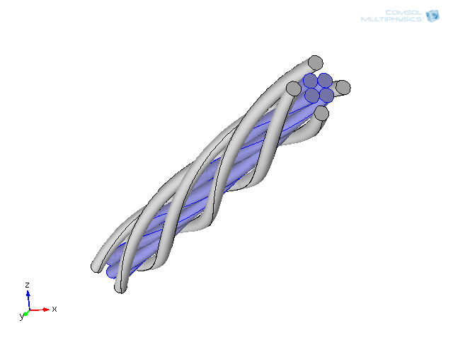

I'm trying to model the flow of current in a twisted wire. The inner rods are of steel, the outer of Al (see attached file). The steel rods are twisted clockweise, while the Al rods are twisted counter-clockwise.
When I mesh it, it fails to generate mesh for some domains.
I would like to ask how to mesh helix structures, when they experience point contact?

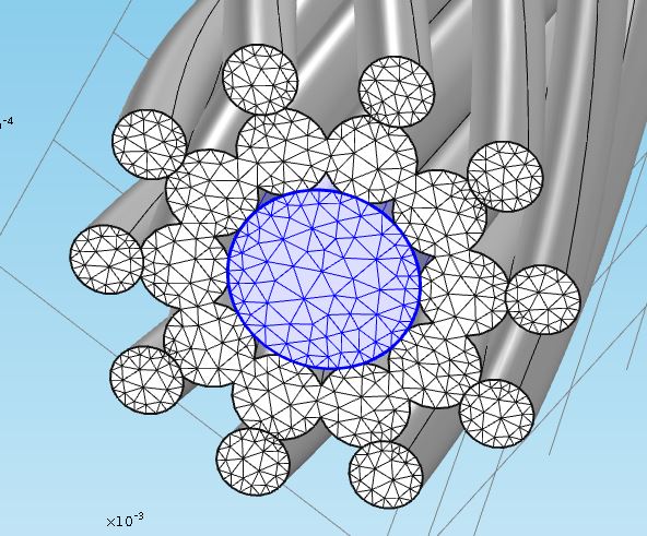

Thank you. Could you please provide some details on swept meshing. All the time I get an error (Unsupported topology of linking face) when trying to do the following thing:
First I mesh several boundaries with free triangular (see attache file).
then I add swept to my Mesh-1 where I indicate source faces to be already meshed in previous step boundaries and destination faces as boundaries on the other side.

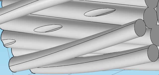

I've already recreated my geometry and turned point contacts into surface contacts (another attached file)
So what am I doing wrong? Or maybe its impossible to mesh the geometry with swept tool?

the swept mesh needs a constant cross section along the sweeping direction. So the interpenetration of wires prevents it from success.
