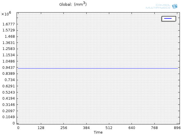

The graph I got has a constant volume with changing time even before the steady state condition but I expect the volume to increase with changing time.
To calculate this volume use to following expression:
intop1(T>=40[degC])-intop1(T>=50[degC])
Sergei
