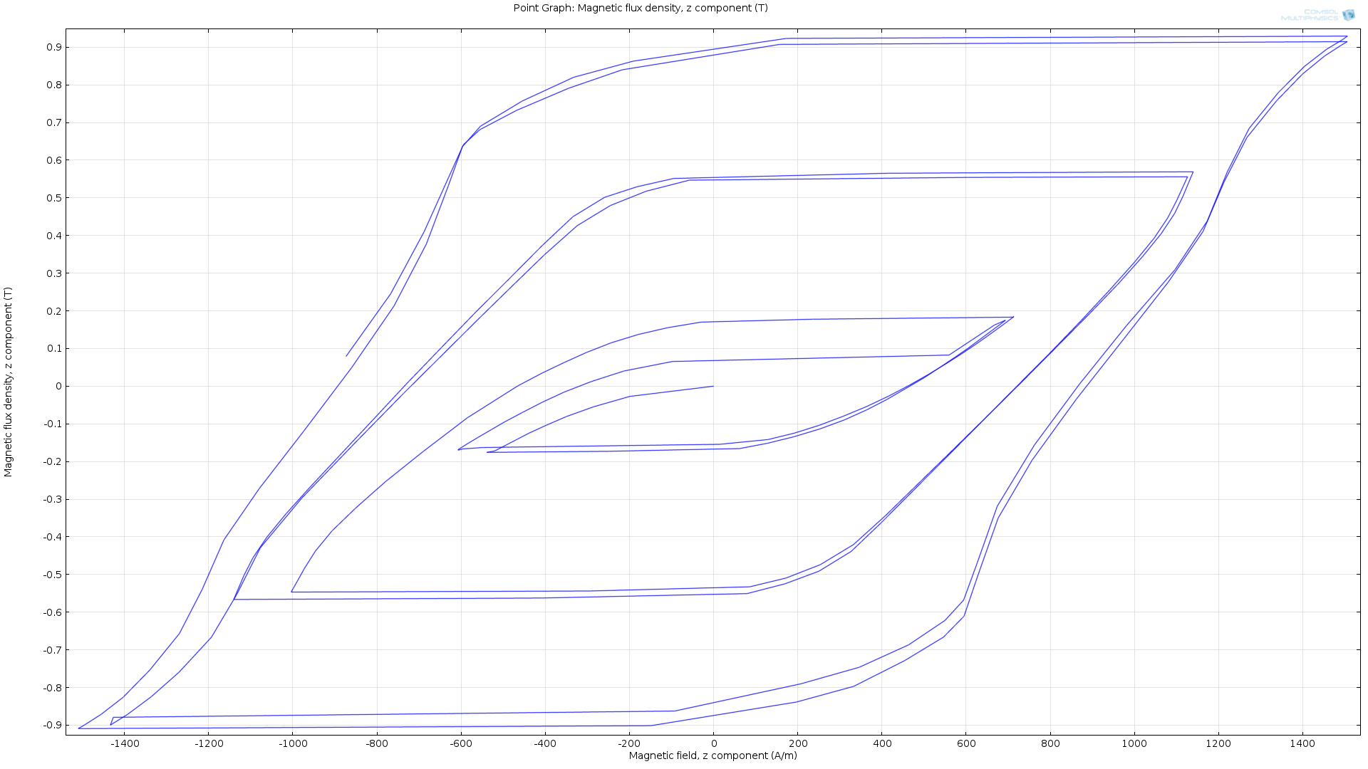

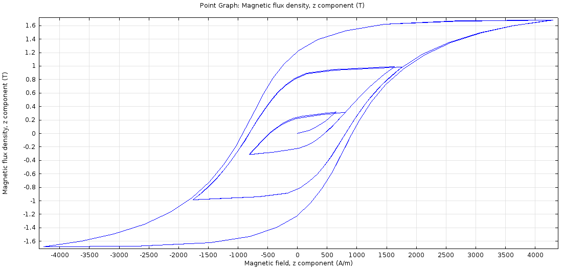

Thank you so much for your help!
It's still not perfect, but It basically works now :)
I attached the Hysteresis Curve I produced :)
Regards
Rook
