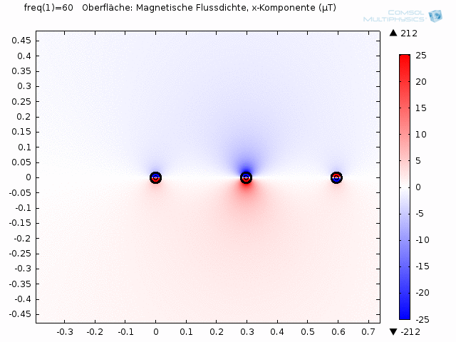

2D and 3D models are the same. the only difference is the distance between cables. it is 0.425 m for 2D model and 0.2974 m for 3D model, I forgot to change the distance for 2D model. All cable parameters, i.e. diameters of conductor, insulation, sheath, armour, aluminium wires and jacket are the same. Yeah, I forgot to mention that 3 phase balanced current is going through the cables. So, my question is will the resistances of 2D and 3D model be same? I would like to run 2D simulation because my computer is not powerful enough to handle complex (because of aluminium wires and sheath) 3D models.

Posted: 1 decade ago Jun 17, 2014, 5:14 a.m. EDT
Dear Akim,
i have solved yout 2d model.
freq = 60Hz
R L1 (mΩ) = 5.73224
R L2 (mΩ) = 5.72243
R L3 (mΩ) = 5.69881
L L1 (nH) = 441.67833
L L2 (nH) = 362.688
L L3 (nH) = 334.39856
Z L1 (mΩ) = 5.73224+0.16651i
Z L2 (mΩ) = 5.72243+0.13673i
Z L3 (mΩ) = 5.69881+0.12607i
hope it help you. The 3d Simulation take a while. Becaus the 3 D Model is not finished and I didnt found any port or coil configuration.
regards Viktor
Dear Akim, i have solved yout 2d model. freq = 60Hz R L1 (mΩ) = 5.73224 R L2 (mΩ) = 5.72243 R L3 (mΩ) = 5.69881 L L1 (nH) = 441.67833 L L2 (nH) = 362.688 L L3 (nH) = 334.39856 Z L1 (mΩ) = 5.73224+0.16651i Z L2 (mΩ) = 5.72243+0.13673i Z L3 (mΩ) = 5.69881+0.12607i hope it help you. The 3d Simulation take a while. Becaus the 3 D Model is not finished and I didnt found any port or coil configuration. regards Viktor
