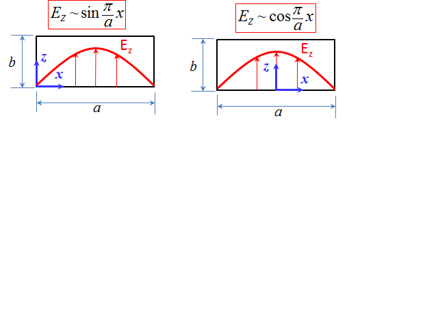

                                                    Referring to the microwave oven model from the model library, the E0 vector was set as cos(pi*y/dg)[V/m] at the z direction. Could anyone please explain to me how was that set, as i'm changing the position of the port for the modelling of my microwave oven and have no idea how to set the E0 vector for my model.
