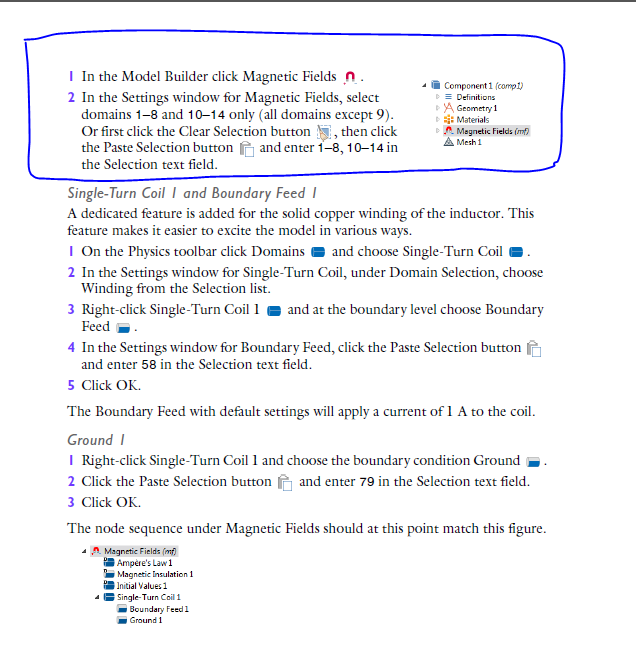

Kristian Rye Jensen COMSOL Employee
Posted: 10 years ago Feb 11, 2016, 12:05 p.m. EST
I had a support case where someone experienced the same problem and refered to the discussion forum. That more people were experiencing this problem.
I've tried to go through the step-by-step one more time. If you don't disclude domain 9, which is written on page 26 on the top. I have attached the image, then you'll receive the Non-applicable for the boundary 58 and 79.
Furthermore I have attached the model until page 27, so you can continue from here.
Hope this helps.
