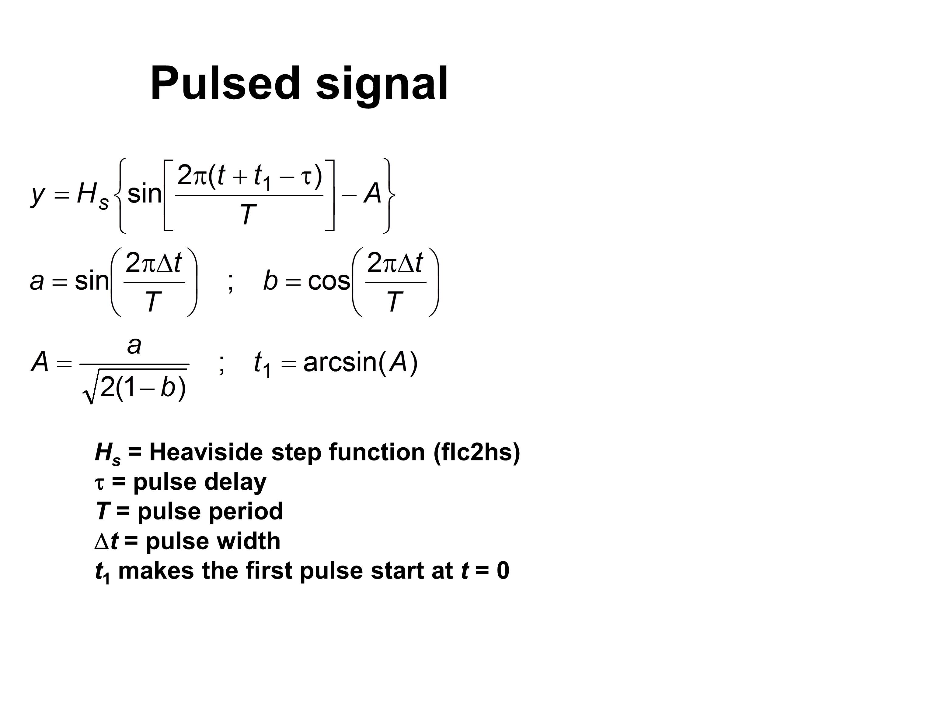

I made this calculations once, when I needed a pulsed boundary condition with an arbitrary pulse duty cycle. I cannot recall any more, how I did it but, please, here you have it attached. It works, I can guarantee :)
Lasse
I made this calculations once, when I needed a pulsed boundary condition with an arbitrary pulse duty cycle. I cannot recall any more, how I did it but, please, here you have it attached. It works, I can guarantee :) Lasse
