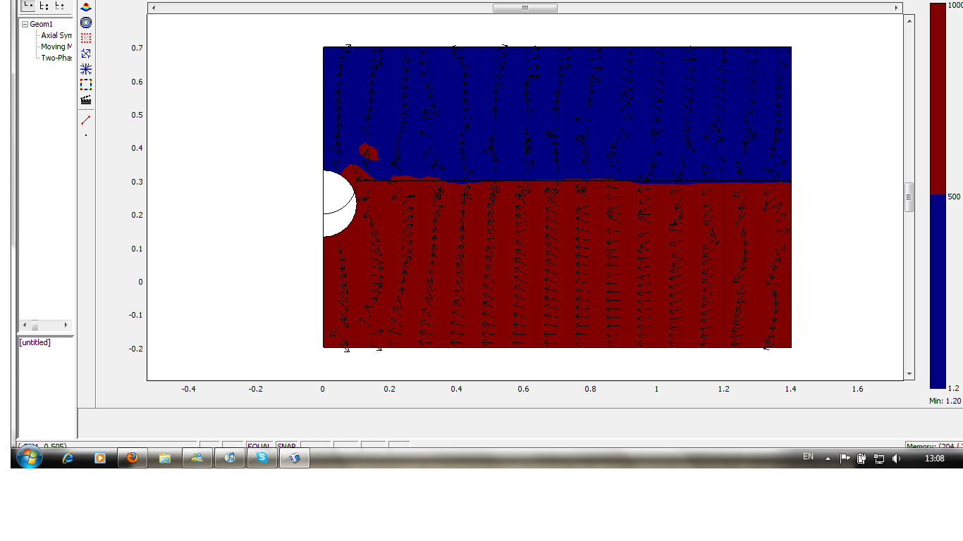

                                                    hi
thanks for your hents , there is another thing my fluid look odd its like jumping every where as in picture i attched. it should not be like that . i am using FSI in MEMS mode.
and another thing any advice to avoid the waves refliction which is comming back after hitting the wall? i did it as out let with velocity=0 but its not working
thanks for u r time
salim
                            hi
thanks for u r time
