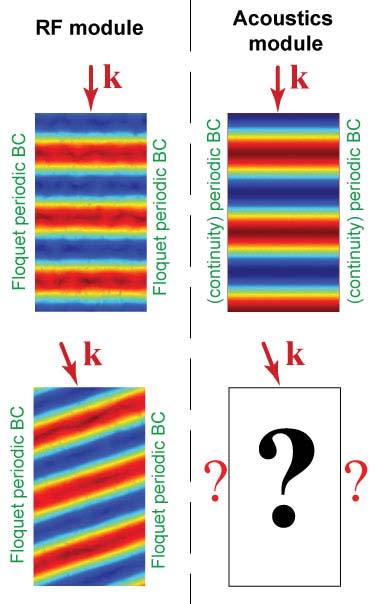

I have a problem to calculate a plane wave at oblique incidence in Acoustic module. In RF module to successfully simulate this wave I use Floquet periodic BC, this BC are available there. In Acoustic module periodic BC have to be specified in menu Physics->Periodic conditions->Periodic boundary conditions, and, at the same time, in menu Physics->Boundary Setting the Sound hard boundary (wall) BC for the same boundary have to be set. By doing this, it is easy to calculate the normal incidence, setting continuity periodic BC. But I did not find the way to specify Floquet periodic BC in Acoustic module. Please take a look at the figure.
So, does anyone know is it possible at all to specify Floquet periodic BC in Acoustic module, and how?
