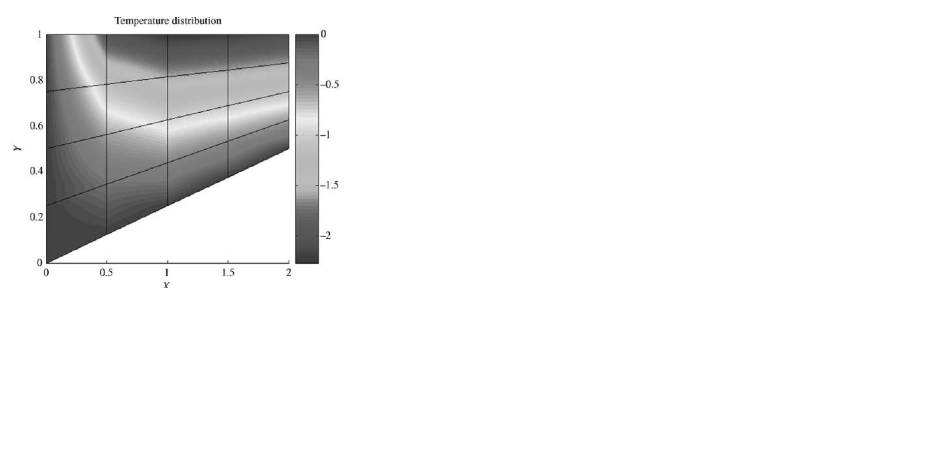

Please i need somebody to help me, what i want to do is obtaining a graphic like this (download the attached file):
www.sendthisfile.com/QH3YqTyenQ7iO3XWAj5X3xsq
In that picture you can see the plot solution combined with the mesh. Can I do this with Comsol 3.5?
Additional I need to see the mesh numeration (elements and nodes) so i can navigate trough the mesh and know the different amount of for example von misses stress, deformation, etc, in each node of the mesh, please help me

Thanks for help me, this is the attached file

After solving your model, you may try Postprocessing>Plot Parameters>
At General tab, check Element selection and uncheck Element refinement and set Auto to 1.
At Surface tab, set Fill style to Wireframe.
Then you can have the plot you need.
Cheers,
David
