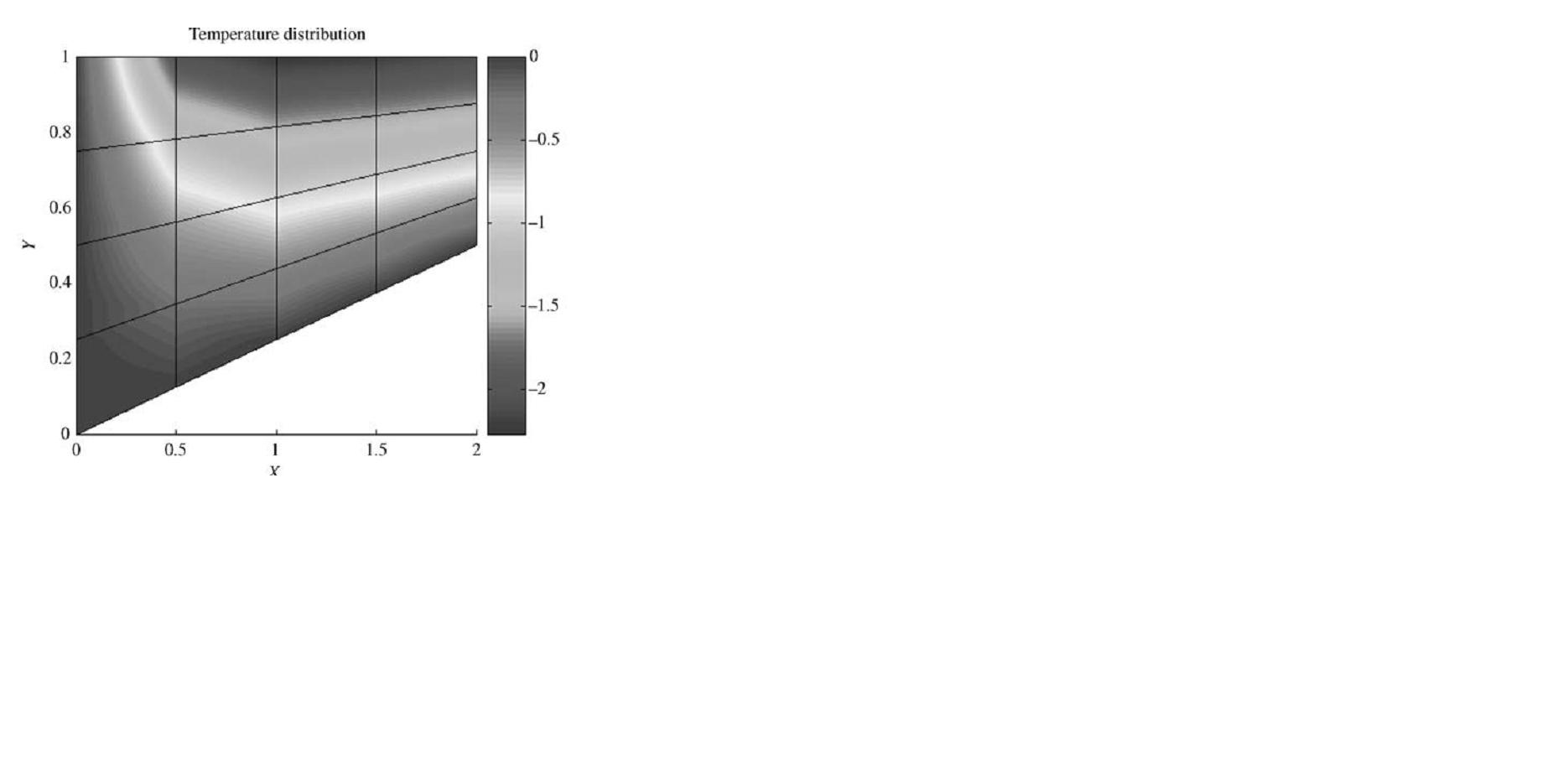

Please i need somebody to help me, what i want to do is obtaining a graphic like this (download the attached file):
In that picture you can see the plot solution combined with the mesh. Can I do this with Comsol 3.5?

Please help me i have tried to do you suggestion for the fist answer but the final plot (wireframe, 1, surface) replace the other plot (von misess stress) so i obtain just the mesh
