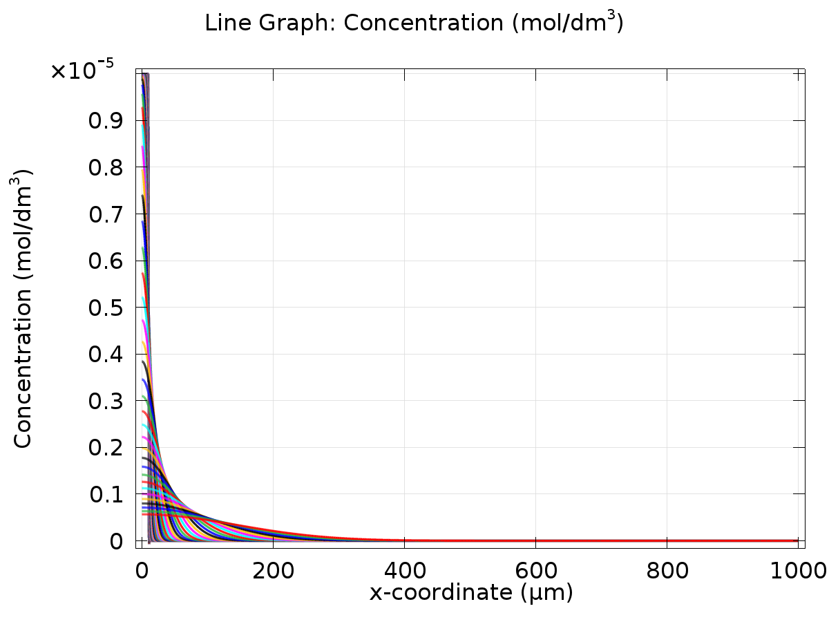

You have thin layer with some initial dopant concentration. Assign the "No flux" condition on the boundary which is facing the "outside world", and at boundary between the layer and bulk no condition is necessary as COMSOL assumes continuity across inner boundaries. Of course, if you have some specific condition on that boundary, use it. I could attach a model but I am using version 5.0. Yet, attached the report file which may help you.
