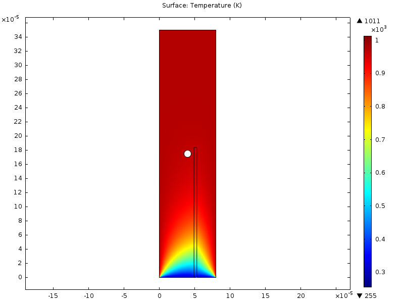

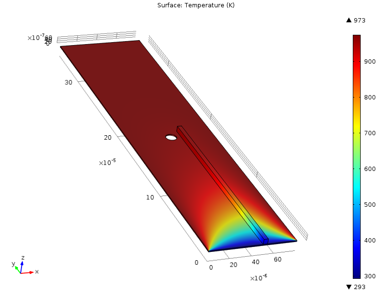

I'm building a 3D Comsol model simulating the conductive heat transfer in a thin membrane with a Pt electrode on top - the point of interest is how much heat the electrode carries away. The temperature is fixed to 973 K on three of the edges and on the last edge it is set to 273 K.
The standard 3D visualization looks as expected: The maximum temperature reaches 973 K and the Pt electrode transfers some heat away. Then, when I visualize the same results by a cut plane placed at the surface the distribution looks identical, however the maximum temperature reached is now 1011K (more than that specified on the boundary!)
Why this discrepancy?
