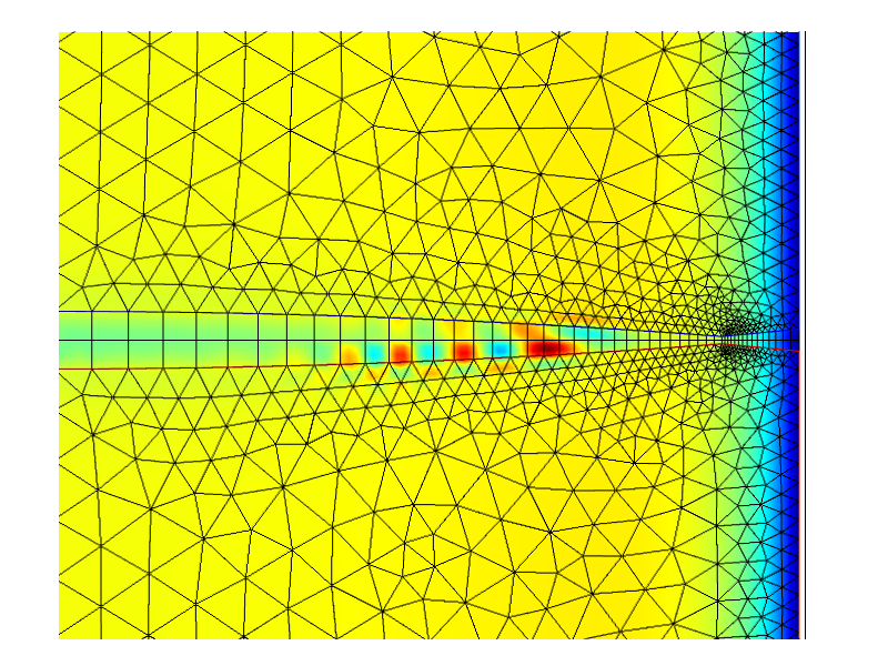

Hopefully someone can help me with a problem I'm having with localized divergence in a time dependent heat transfer problem. I've attached a picture of one of the solution steps which show the behavior I'm talking about.
The geometry consists of two solid pellets separated by a gas filled gap. Solid mechanics is used in the two pellets to calculate deformation due to thermal expansion and heat transfer is active in all of the domains. The two pellets will eventually expand and come into contact with each other (save a small gap to prevent topology issues for the domain in the middle). Heating occurs only in the solid region, not in the gas.
The picture shows one of the temperature profile from one of the solver steps. All materials were started at the same temperature and the solid region was heated volumetrically. I've included the mesh in the output, although I do not believe this to be a mesh dependent problem as I have encountered the same problem with a much finer mesh.

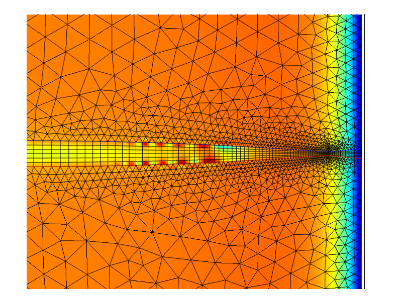

Opps. I realized I didn't attach the pictures I intended. Here they are.

It looks indeed funny.
But what are the relative scale of these values, I have "burned" myself sevral times loking at beautifull rainbows of funny effects, then to see that the relative scale was down in the 1E-6 or 1E-9 and could easily be expalined by numerical instabilities due to the binary representation of numbers and the limited resolution from our numerical CPU's.

Thanks for the reply.
The colour range represents a difference of about 3 k, from about 499 to 502. I've attached a simplified version of the model I'm working with if it helps.
