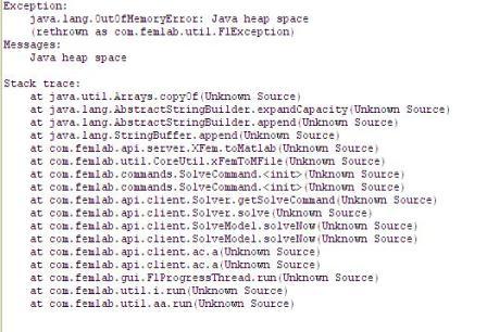

Thanks for the answer Ivar.
I've read the references you mention, and I've tuned the size of the Java heap space, but it does not seem to work.
I've attached the error displayed by Comsol, does anyone know if it is a problem of memory while post-processing or during the calculation itself ?

I encountered the same question druing the parameter sweep. and I can not find the comsol.opt in comsol4.0a, so I want to ask you how can you fix it?
Thanks a bunch!
Thanks a bunch!

There is no comsol.opt file anymore for version 4.0. However, under \COMSOL40a\bin\win32 or \COMSOL40a\bin\win64 there are the files comsol.ini and comsolserver.ini. The maximum Java heap size is defined as the numeric value after -Xmx. The default is -Xmx1024m or 1024 megabytes.
There are other configuration options here which are specified in \COMSOL40a\java\win64\jre\bin\server\Xusage.txt or \COMSOL40a\java\win32\jre\bin\client\Xusage.txt.
