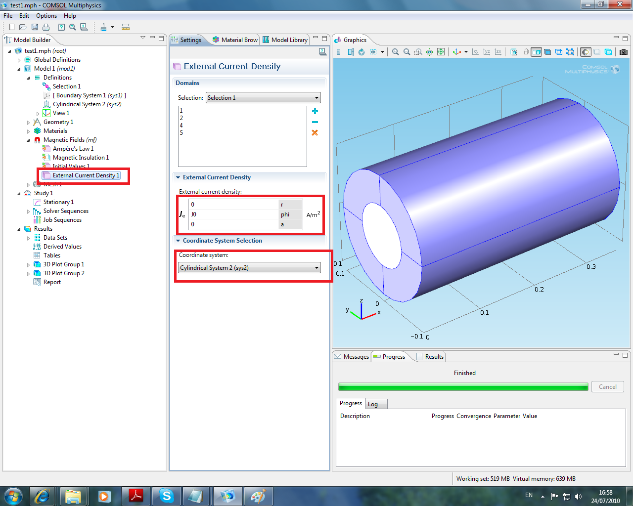

I defined cylindrical coordinate system , and as you explained "Je=(0;J0;0).... but i got current only on Y axis and not circular shape.
Its seems like it still use global coordinate system.

Are you shure you have selected the right coordinate system when you entered (0,J0,0) because it looks indeed that you are using the default one. in V4 you must define it under Model>Definitions>Coordinate system, and then when applying BC's you must select the coordinate system to use from the selection list. In 3.5 its basically the same, but the definition of the CS is elsewere (I do not have access to COMSOL from my current holiday residence ;)

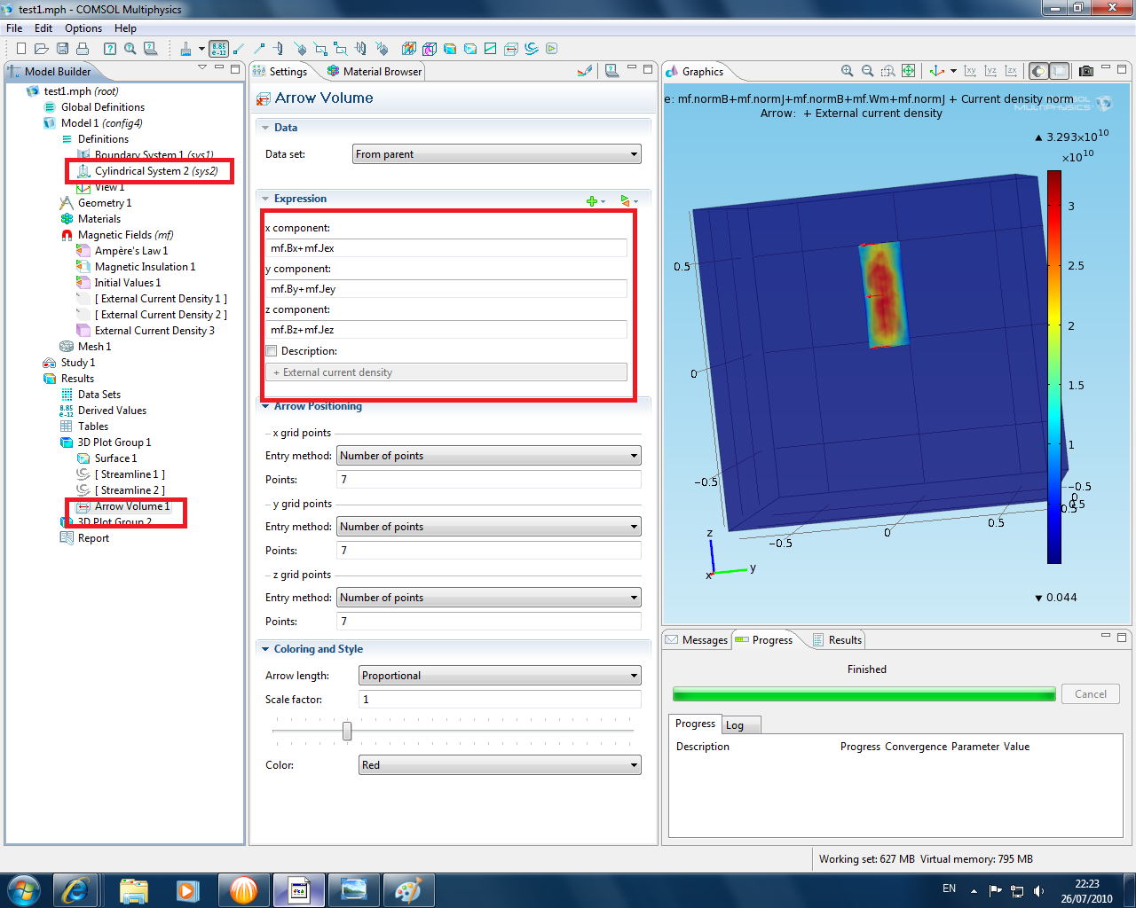

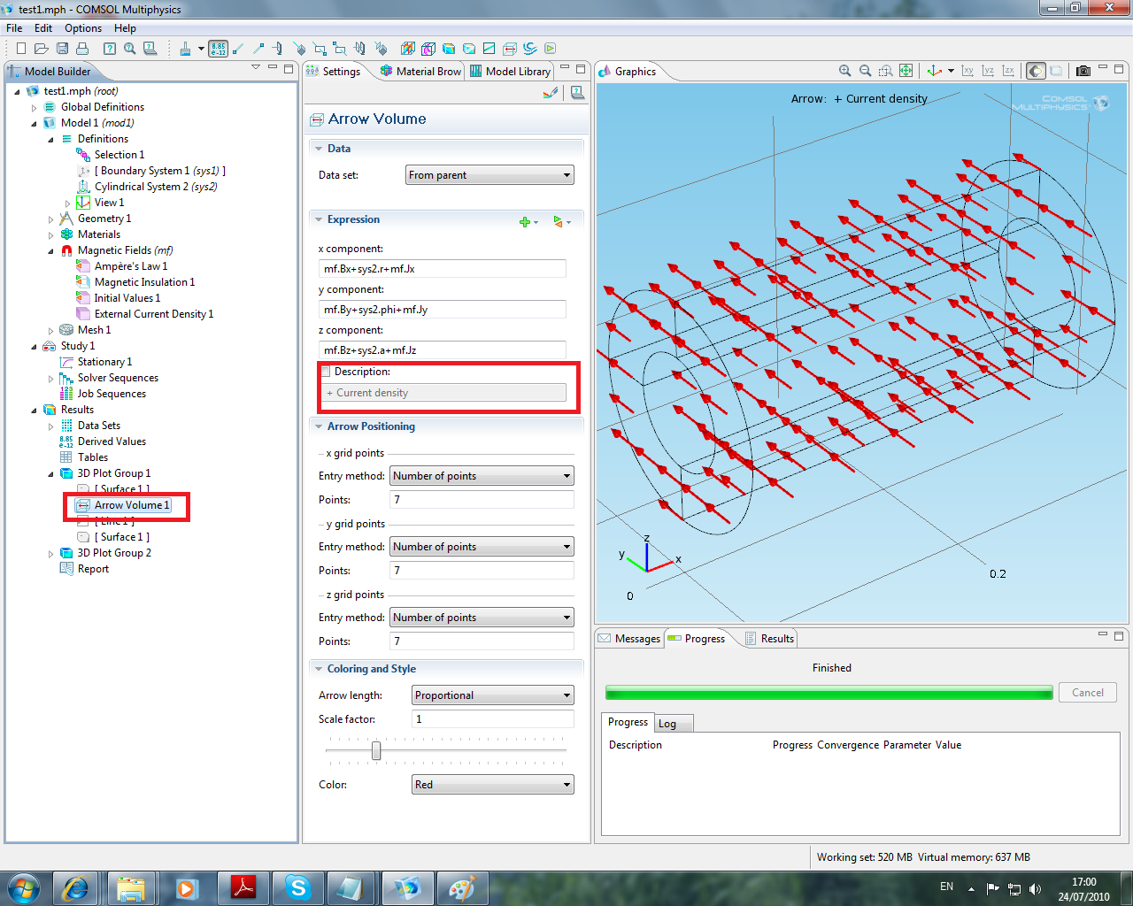

I simplified the problem, the magnet just laying on X axis and still its not working....
Please check the pictures , its the steps as i deffined ...

Well from the two first images I have nothing to say, from the last one I see a suspicious item in your formula:
y component (also by similarity for the others):
mf.By + sys2.phi + mf.Jy
I would have expected a transform value for the sys2.phi to x,y and z and not the raw sys2.phi value.
Normally there is a way to get the inverse transform of a coordinate change. But as my holiday demo version is out on date, I cannot check how this is now.
Have you tried to use the keyboard shortcut CNTR+space to get the variable name lists ? Normally the built in variables take care of the coordinate change. There is also the Show Equation and checking of how COMSOL fills in the current density as it should normally get the cartesian values from the coordinate change

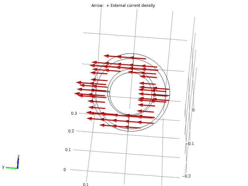

Meanwhile i reinstalled comsol, so now something else occured, when i am trying to defiine Cylindrical coordinates and i choose material frame, its cant be choosen to be coordinate system ( it not appear in the selection window )....but if i choose spatial frame the it seems ok, but still wrong directions :(
See picture attached
