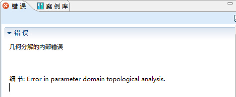

I have some troubles with the problems of geometry in comsol. I have built a 3D model with comsol 4.3b. There are crosses of geometry and some boolean operations, in which some geometry's size is very small .
When I change the their's relative location by the the parameterized scanning,So the problem is the 'Error in parameter domain topological analysis.' The simulation can not continue successfully.So could you help me solve the problem? Thank you very much.
I have exactly same problem. I am trying to take a difference (in boolean sense) between two solids: a cylinder supplied with a conical tip of various angles and boxes. I have experimented with different resolutions of the revolution operator (as the first object is obtained through revolution) as well as with reparation tool tolerance. Yet, there is no effect.

Looks like the problem is common. I have found some more information here:
comsolcfd.blogspot.no/2014/10/internal-error-in-geometry.html
Basically, it says there is another switch in tolerance of the "Form Union" node. I have tried with that one as well, but it seems to work at random in my case. You may try, maybe that will help you. Good luck!

I'm new in Comsol. When I build a circle with 0.05m radius on a cylinder with 200m radius, the circle is shown like a square. I tried to solve the problem by changing repair tolerance but it makes this error: - Detail: Error in parameter domain topological analysis.
I thick the problem is the wide rang of tolerance (0.05-200m), but I don't know the solution.
