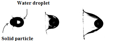

I want to model collision of a particle into a droplet. A ​water droplet is falling by gravity and a solid particle is shot toward that to ​hit the drop.​ Collision outcome is a conic liquid film​ which forms like a liquid skirt for particle​ (please see lamella formation in attached file).
​I need to simulate this phenomenon and compare the results with what I get from experiments. However, I need first to choose the most suitable simulation software capable of considering the followings:

Based on my understanding so far, if I want to simulate this with Comsol, I can use currently available standard features for some parts, but I should also introduce my own equations for others. While I'm not a numeric man, do you think that for those parts that I should adjust Comsol myself, if I read some available Comsol models and also get related equations that I need from literature, then would I be able to come up with a satisfactory model for this case? (also if it's possible for me to get some technical helps from Comsol support in some points as well). Do you think that this way is doable for building an appropriate simulation?
I am know doubting whether it's better to choose Comsol OR another commercial software/code like Fluent or OpenFoam.

Why not start with a try: a 2D axi case with a rectangle and 2 smaller half circles, one is the fluid "sphere" i.e. the top one, the other your fixed body, the surrounding is air, and you let them interact, by giving a downwards velocity to the fluid "sphere" (velocities are relative at least at low speed, you can always stop one item and simply correct the velocity of the other item to have the same relative velocity between the two items, no ?) And then see how the fluid behaves. You will need to use the 2 phase flow, not sure which to select first, need some tests here, and be careful with the mesh to ensure correct conservation of the mass.
I'm not saying this IS the solution to your demand, but its something you can do with current built-in features. Thereafter you need to knit in your additional equations, one by one.
