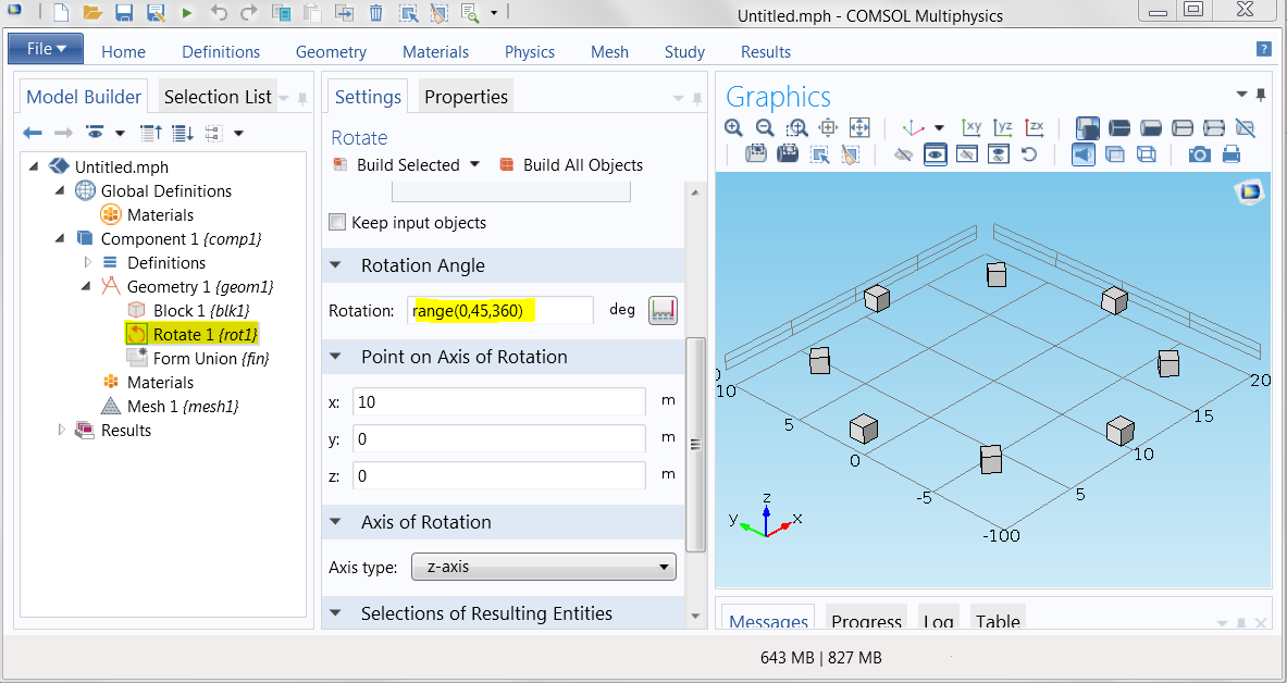

rotated pattern of geometrical entities
I am wondering if it is possible to make a rotated pattern of a geometrical entity (for example make N copies of an object, the nth copy being a rotated version of the original one by n*some_angle, around a defined axis)
This would be analogous to the Array operation which makes N copies linearly or in a rectangular pattern.
Thank you
Daniel

Dear Sven,
Thank you! How can I do this?
Daniel

Sven Friedel COMSOL Employee
Posted: 1 decade ago Aug 11, 2015, 5:23 a.m. EDT
Dear Daniel,
please see my attached file - and - in case you are not running COMSOL 5.1 yet - the screenshot.
Best regards,
Sven
Dear Daniel, please see my attached file - and - in case you are not running COMSOL 5.1 yet - the screenshot. Best regards, Sven
Posted: 1 decade ago Aug 12, 2015, 6:52 a.m. EDT
Uhhh, how can I have missed this so far?
Thanks a lot!
Daniel
