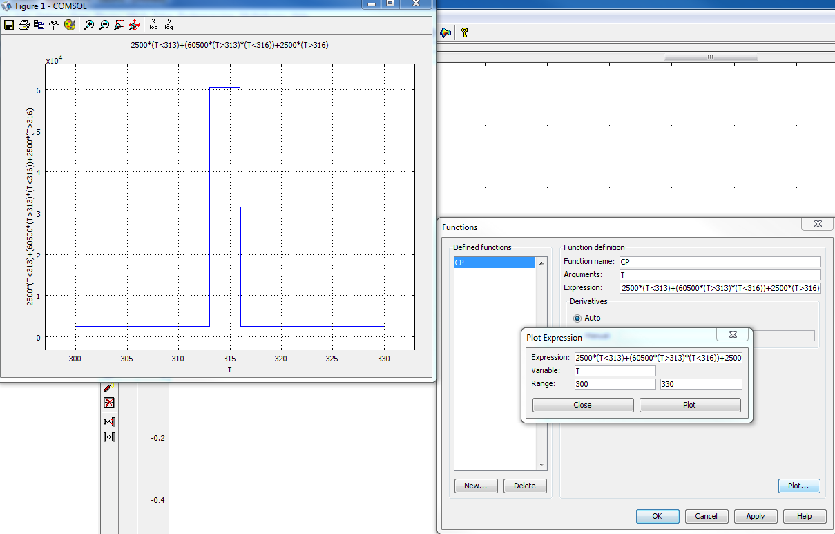

I have a material that change phase from 313 to 316 K. The melting cp is 60.5 kJ/kgK and the cp from solid state is 2.5 kJ/kgK, and I type this into the program
Cp= 2500*(T<313)+(60500*(T>313)*(T<316))+2500*(T>316)
It works, but now i would like to plot the function in order to check the latent heat, if the integral of that cp function is the latent heat of my material i could validate the formula. My model is in 2D in COMSOL 3.5a.

in 3.5a I would define a function like this, but then your function is very square, with undefined gradients during the transitions, its better to smoothen these with a heavisde function as discussed in seceral threads on the forum. In V4 zhis is called by the "step" function

Thank you so much for your replay... I will try to make my cp's function with the heaviside functions or the rect() function, but what do you mean about not having gradient temperature at transitions? and do you know if i can integrate my cp function in order to obtain my latent heat ??
