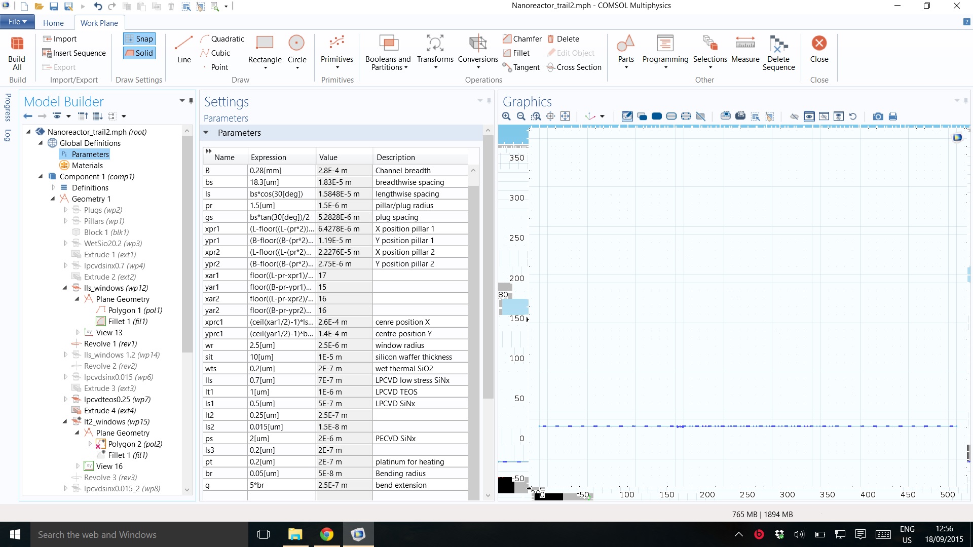

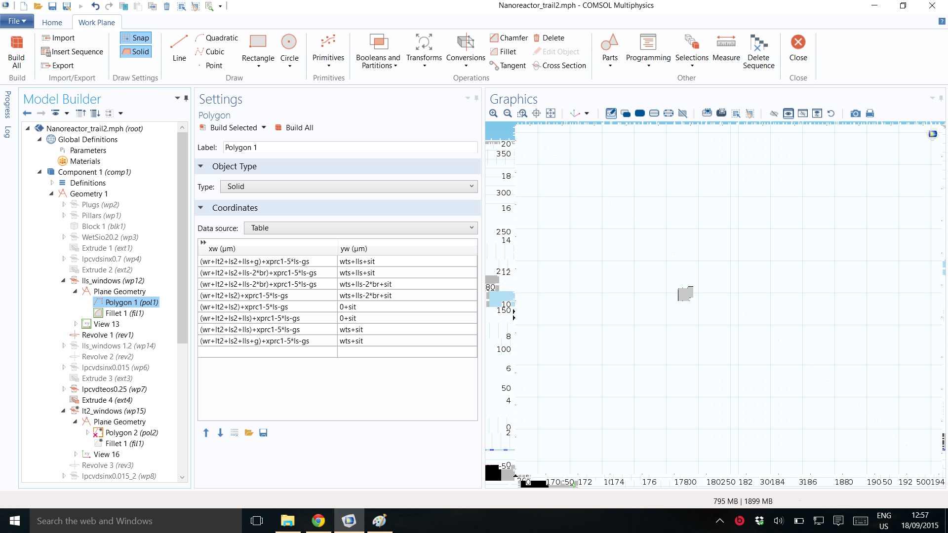

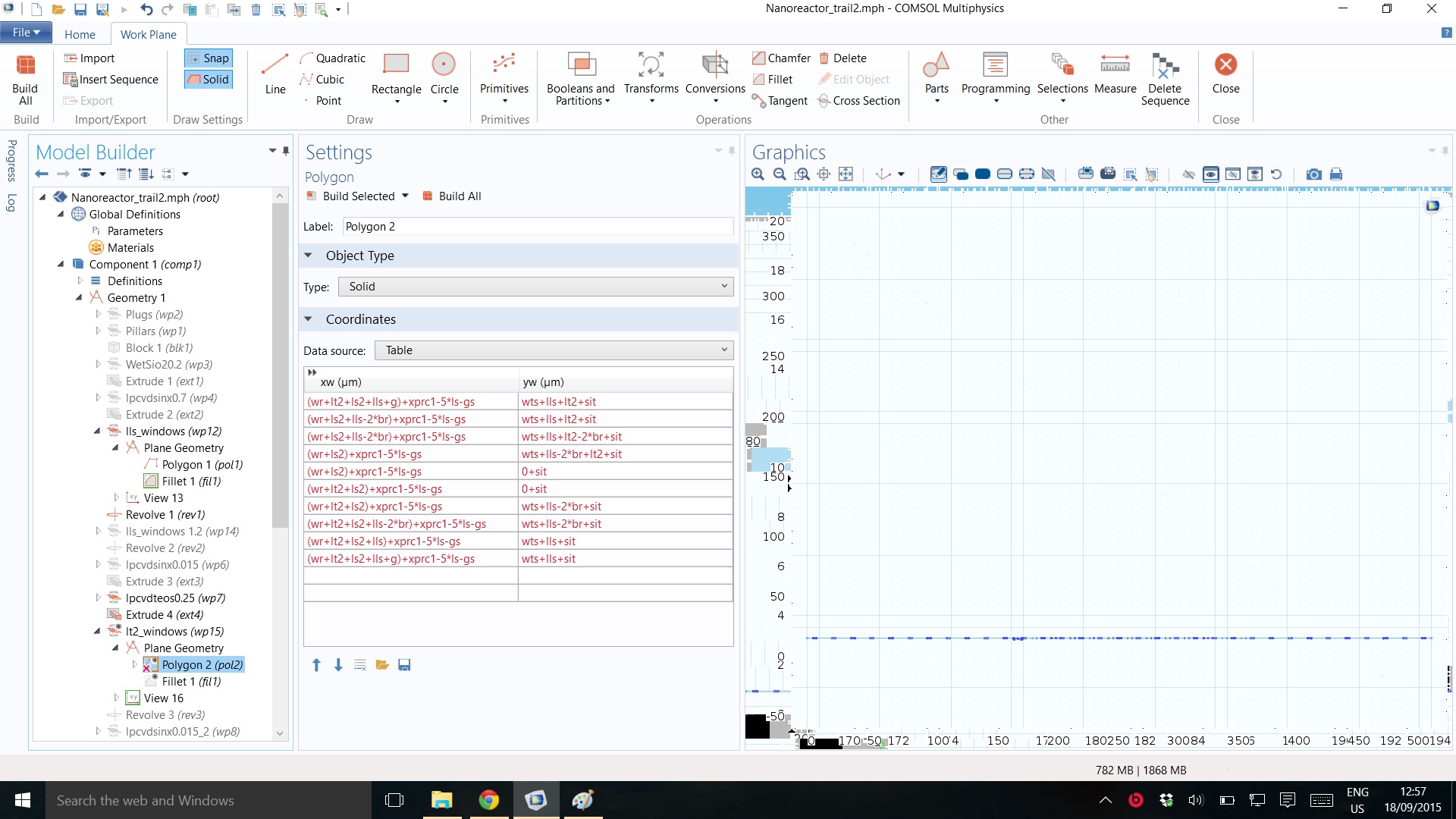

I specified all the required parameters under definitions. I builded many other structures using those parameters. Now i'm trying to build a polygon in a work plane (I previously a polygon using those parameters in another work plane). I don't have a clue why it is not working this time. for further understanding pls ref to the screenshots attached.

I sometimes see this behavior too. Sometimes it helps to click into the Parameter table and back to the geometry definition. Sometimes I have to delete the parameter (not the whole list) and enter it again.
I hope we will see the option to define more than one parameter list in the near future. Just like we can define several variable lists.
This would greatly improve our options to parameterize models with regard to different model aspects and avoid scrolling up and down long parameter lists.
