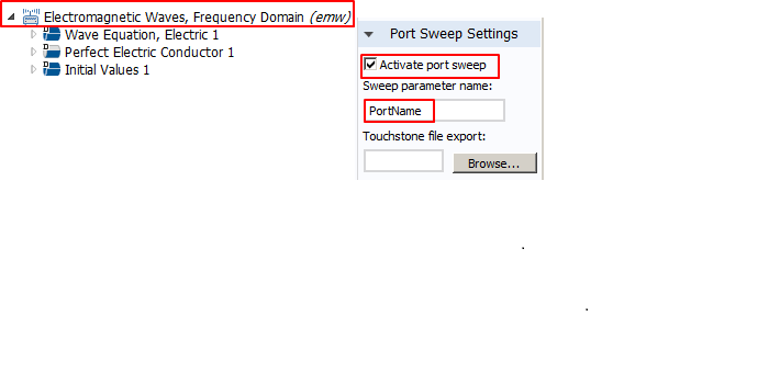

Cris,
Yes, there is an automatic way to calculate full matrix of S-parameters. In the Settings window for the “Electromagnetic Waves, Frequency Domain (emw) root node, there is section “Port Sweep Settings” where you can check “Activate port sweep” option, as shown in the attached image. This will allow you to perform sweep over the one active port at a time and extract full S-matrix using Global evaluation node.

Cris,
