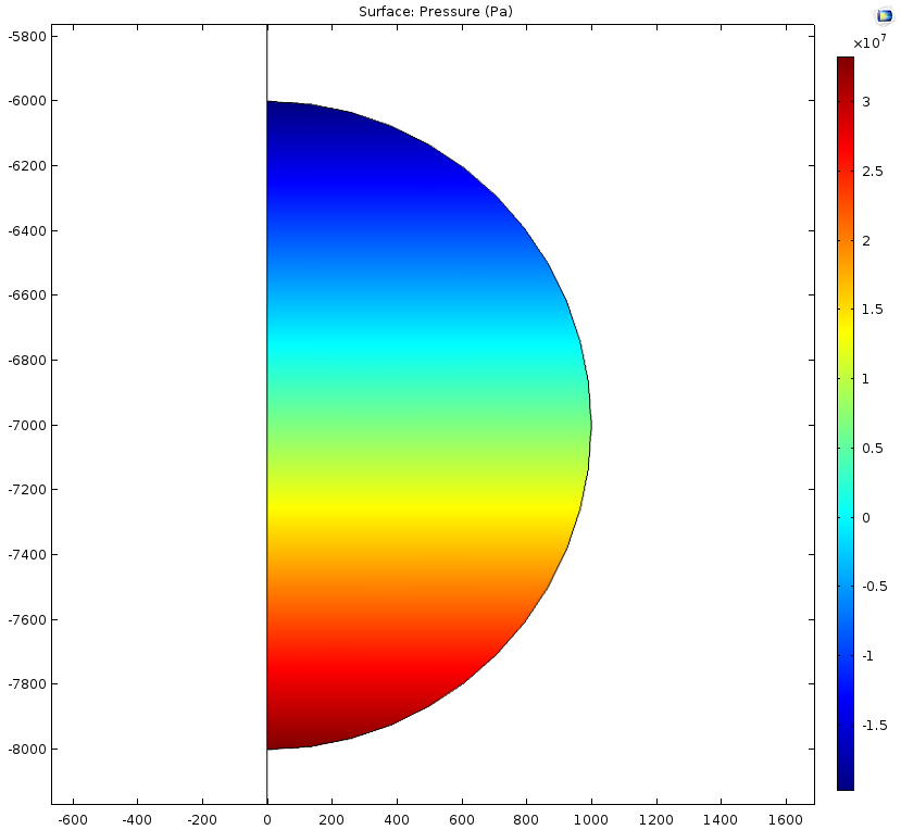

I am still not understanding how the volume force works.. On the figure attached, you can see the fluid pressure when just subjected to the applied volume force of - rho * g , not any other force, and just solving for the fluid part. I am not understanding the sign and magnitude of it, which are not equivalent to -rho*g*z.
Thanks,
Helene
