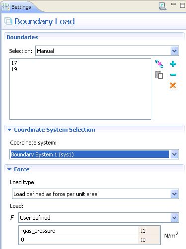

Can some explain to me how the new system for formal and tangential directions works?
I'm trying to add a load to a boundary in a solid mechanics module. This was super easy to do in 3.5a, but it isn't clear to me in COMSOL 4.0a what is really happening.
In COMSOL 4.0a, when I add a boundary load, I am able to select "Boundary System 1 (sys1)" for the coordinate system. This boundary system is an item under definitions however I don't know what any of it means. I am working in a 2D axi-symmetric geometry and this window produces (t1,n,to).
When I try to apply a forces using "Boundary Load", my only options are in the 't1' and 'to' directions but no normal direction. I have been producing boundary arrow plots trying to figure out what those mean but it still in not clear.
I have been able to plot the normal vector using (nR, nZ) and (nr,nz) but there is no (n,t) option under the boundary load so I don't know how I am supposed to do this.
I have tried reading the help and documentation but it still isn't clear to me. Can anyone explain this? Does anyone have a model from 4.0a where this is clear?

I do not have the feeling it has changed from 3.5a, apart from the presentation:
if I take the 4.0a in 2D axi I see "n" for normal to the selected boundary, "t1" for the first tangeant, defined along axis "2" by default and "to" the out-of-plane tangent (perpendicular to the screen, or along "phy" the rotation angle around the 2D axi axis).
the thing is that COMSOL has axis 1, 2, 3 defined by default as x, y, z (for 3D)
but in 2D-axi it's r, z (implicit phy for the third),
while in standard 2D it's x, y and z out of the plane

That is helpful. But I still don't see a box to USE the normal direction for a boundary load. I've attached a picture to show what I'm talking about. The only options are to apply forces in the t1 and to directions, which as you have described are actually tangential and out of the plane directions.

I looked a bit more, and it only looks like this for the 2D axially symmetric case. For both the "solid mechanics" and "thermal stress" physics modes in 2D axially symmetric the normal direction is not available.
Thoughts? I'm assuming this is a bug in the physics mode GUI? I would imagine it is supposed to look like it does for the 2D Cartesian coordinate case. Is there a way of fixing this or do I have to wait for a patch or version 4.1?

I do not understand why you define a pressure (by default a boundary NORMAL item on the tangeantial vector direction !, it shoudl be always on "n" for me.
I suspect that you have not catched that the boundary coordinates are not fixed in "global" space, but defined "per boundary" you select, or that COMSOL consideres.
In Comsol there are many "implicit" assumptions, i.e. all physics apply to a "finite element" hence a "dV" an elementary "small" volume. This explains why a body load or gravity is by default defined as g_const*solid.rho (where g_const is the gravity acceleration 9.81[m/s^2]). This because implicitely we define expression to be integrated over the TOTAL volume summing up all small FEM items of volume dV to get to aour final CAD geometry V.
The same for boundary loads, expressed in pressure [Pa] units as these apply to the boundary (dA) of the small volume elements (dV), hence implicitely to be integrated over the boundary surface ...
Ivar,
I agree 100% that a gas pressure force generally acts normal to the boundary. The problem is that when you select the 2D axially symmetric option, there is no normal vector for me to apply it on! If you look at the picture closely, you'll see that I have selected "Boundary Frame" which should allow me the option of applying forces in the normal and tangential directions (as it does if I select 2D Cartesian) but there is only the into tangential and out of the page directions. Furthermore, if you look at the equation mode, it doesn't look complete.
I think I'm either miss understanding how something or this is a bug in the COMSOL GUI.

I got a very helpful private message from one of the COMSOL staff with a workaround. I figured I'd post it in case anyone finds this thread with similar problems.
I suspect this is a bug in the 2D axisymmetric case. We are investigating it.
In the meantime, there is a workaround. In the 2D-axisymmetric case the outward-pointing normal vector has components nr and nz in the r and z directions, so you can take advantage of that to specify your load, e.g. provide components -po*nr and -po*nz for your distributed pressure of magnitude po.
Notes
1/ you can plot the (nr,nz) vector using a line arrow plot to visually check the above.
2/ if you need access to the tangential vector you can build it easily: it has components -nz and nr or nz and -nr (depending which direction you want it to point).

go your point (finally), indeed loks like a bug, V4.1 is on its way for the COMSOL conf in Boston I have heard, so then it's most probably fixed.
But I have noticed now that it applies to ALL boundary coordinate systems, systematically !!
Really worth to get it fixed ;)
