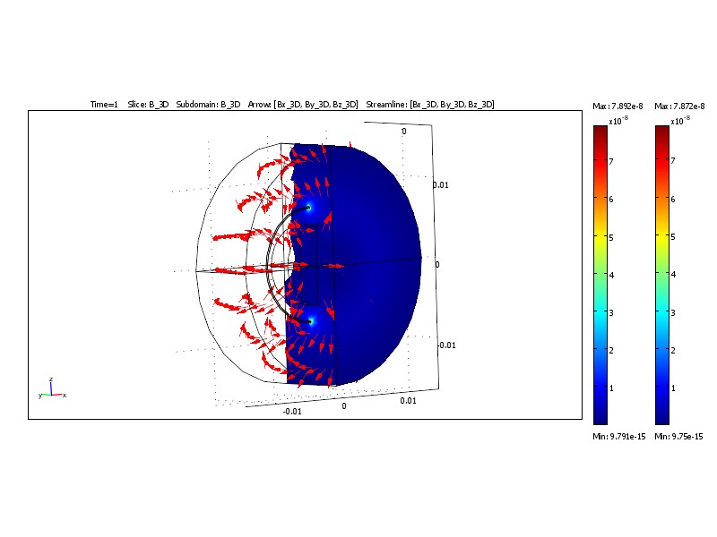

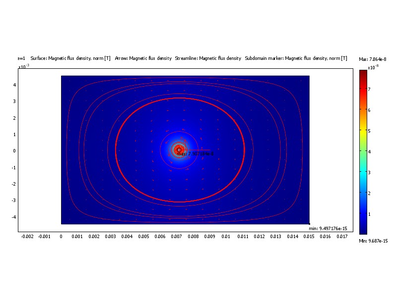

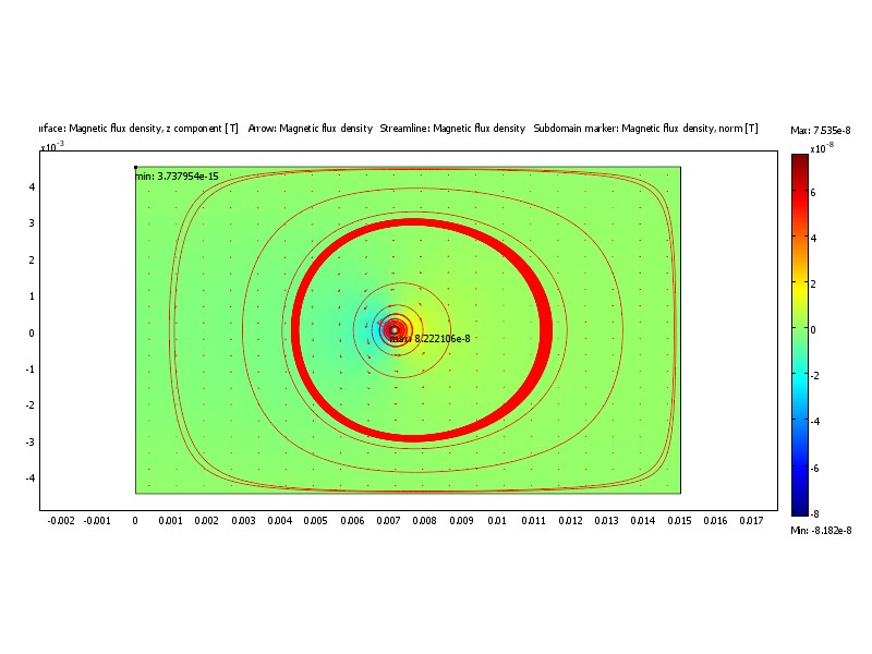

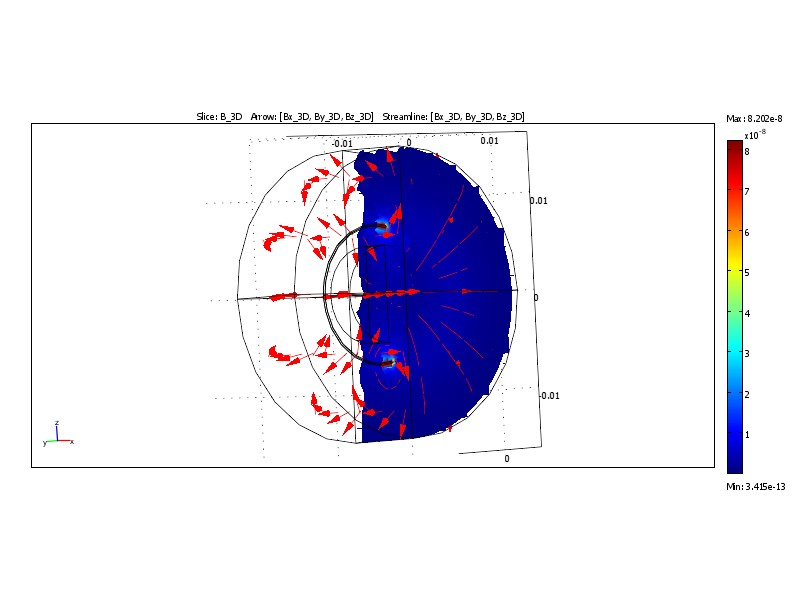

                                                    I modeled a circular cross-sectional area wire forming a loop (a coil) carrying current in 2D axisymmetric mode (azimuthal induction current, vector potential). . The model is just a circle which represents the cross-sectional area of the coil wire and this small circle is inside a big rectangle which represents the surroundings.
I solved the model and also revolved and mapped the solutions into 3D using extrusion coupling variables
Then I did the same model but instead of starting in 2D axisymmetric mode, I started in just 2D (x,y) coordinates using perpendicular induction currents, vector potential.
In both models, All the geometric parameters are the same, and also the subdomains sub domain settings, but THE VALUES FOR THE FIELD VARIABLE FOR THE SAME COORDINATES, Magnetic Flux Density, B, (BOTH IN THE MODELING PLANE AND ALSO IN 3D) ARE DIFFERENT in both models.
QUESTIONS:
1- In 2D axisymmetric mode (r,z coordinates) I used in z, the axis around which I later I revolved the circle (cross-section of the coil loop) AXISYMMETRY as boundary condition, and the rest of the sides of the rectangle that represent the surroundings I used Magnetic Insulation as a boundary condition. But in 2D (x,y coordinates) I don't have Axisymmetry as one of the options for boundary conditions. Which condition is equivalent to the Axisymmetry in order for the both models to be equivalent. (I used Magnetic Insulation and the values didn't match, and I also change the Axisymmetry condition in z axis in Axisymmetric Mode, for both models to be the same, and it didn't work either: the values were different).
2- In a plane, around a wire carrying a current I, the magnetic flux density at a distance r from the center of the wire should be, according to books, B= mu*I /(2*pi*r). In any of the models the magnetic flux density has the value given by this equation and I think it should be the same, because in both cases the current is perpendicular to the modeling plane, and the Magnetic Flux Lines are concentric circles around the wire. What's happening?
Thank you ALL,
P.S. I am attaching two images of the models for the differences to be shown.
QUESTIONS:
Thank you ALL,
