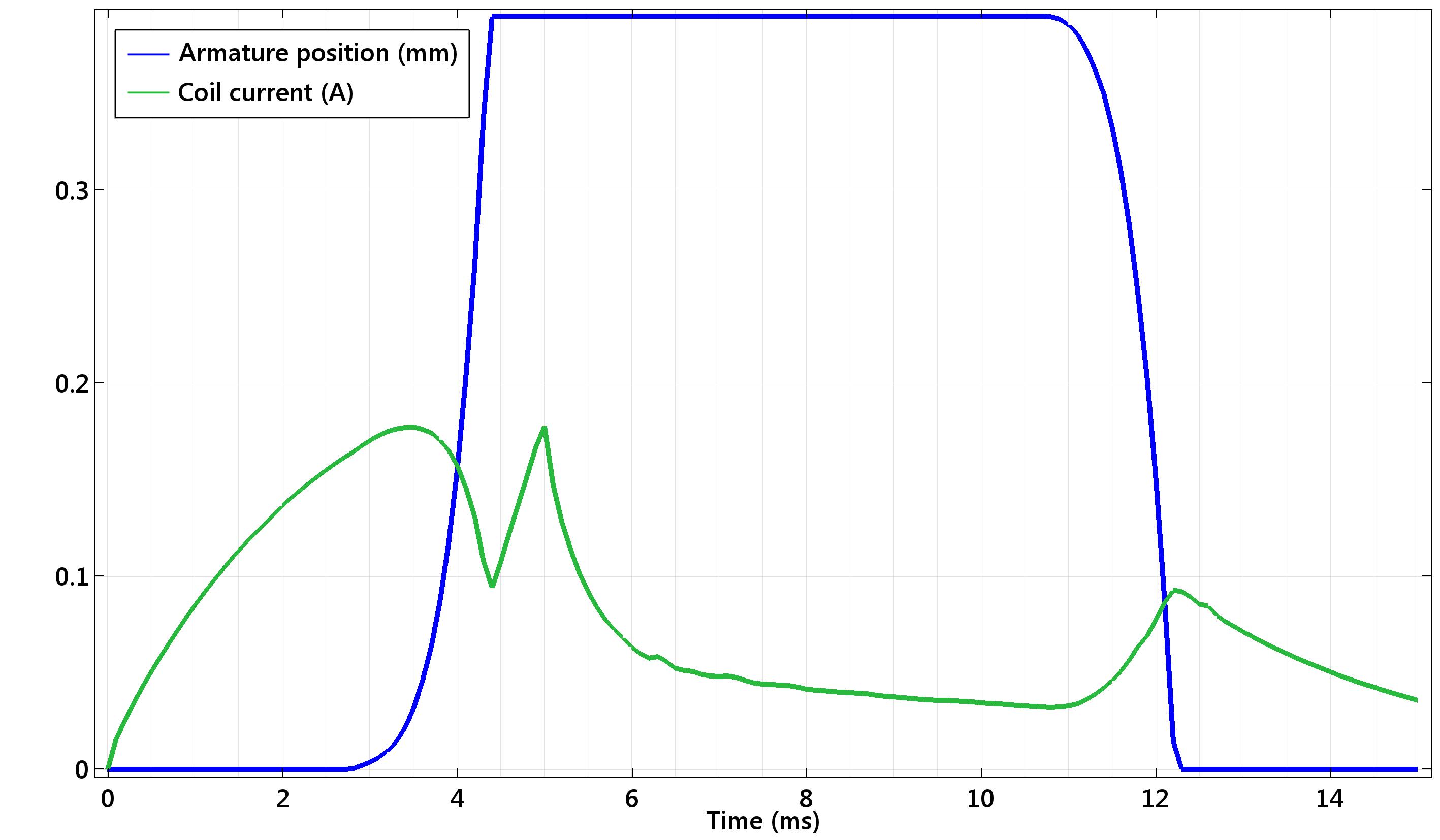

Posted: 9 years ago Jun 13, 2016, 8:37 a.m. EDT
take a lot at this model
Nirmal Paudel COMSOL Employee
Posted: 9 years ago Jun 18, 2016, 1:42 p.m. EDT
Hi Pavlos,
It the motion of the plunger is limited, you could use the approach technique in this blog post.
www.comsol.com/blogs/part-2-model-a-linear-electromagnetic-plunger-with-a-blocker/
This will make sure that your plunger is not interfering with the other parts.
Best Regards,
Nirmal Paudel
Hi Pavlos, It the motion of the plunger is limited, you could use the approach technique in this blog post. https://www.comsol.com/blogs/part-2-model-a-linear-electromagnetic-plunger-with-a-blocker/ This will make sure that your plunger is not interfering with the other parts. Best Regards, Nirmal Paudel
