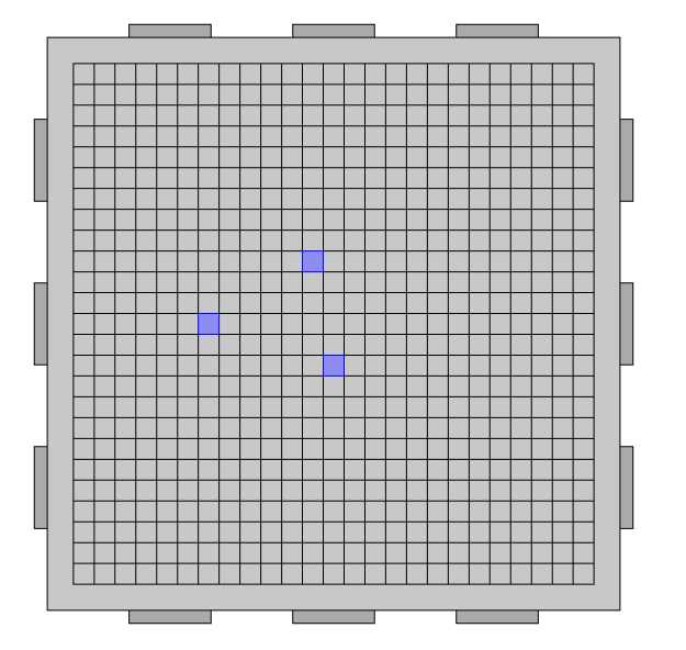

Hello everyone,
I am using AC/DC module. The geometry has a lot of domains, which is shown in the attached file. Now, I want to add different materials with different relative permittivity to each domain. But it really takes a long time (my code in comsol with matlab is shown below). Is there a quick way to achieve this?
Thanks
parfor n2=1:4096 %no of grids
model.material.duplicate(strcat('mat', num2str(n2+3)), 'mat1');
model.material(strcat('mat', num2str(n2+3))).selection.set(n2+2);
model.material(strcat('mat', num2str(n2+3))).propertyGroup('def').set('relpermittivity', grid_permittivity(n2));
end

These 4096 domains do not have to use 4096 distinct materials. The difference is only in their relative permittivity. So do you have any suggestions to achieve this goal.

If you only have a set of a few refractive indices to work with then I suggest you create these as materials and give them proper names. This makes it easier to follow your modelling later.
If you really have 4096 distinct values that depend on which domain you are in then I suggest you create an interpolation table (using the nearest neighbour method). Use the variable "dom" as the input and have the refractive index as a output.
Then you just need to find which domain number (dom) corresponds to each domain in your geometry. You can use the functions mphselectbox or mphselectcoords for this.
