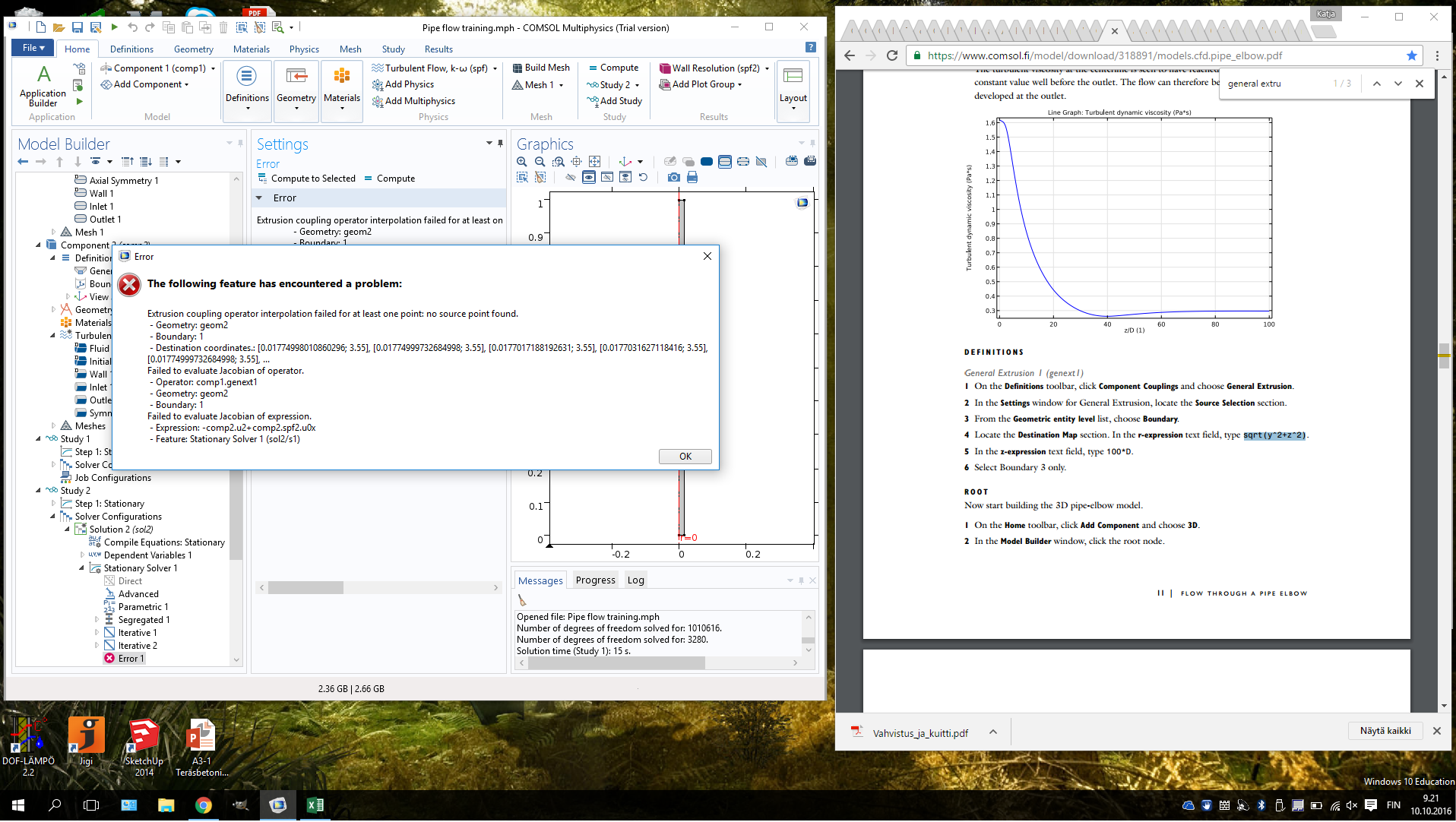

PPS. I tried to build the pipe elbow model myself, but the issue with comp.genext aroused (picture attached). Couldn't find any difference between my model and downloaded one, any help appreciated!
