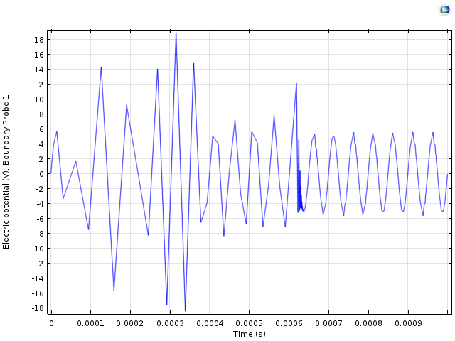

First, I obtained strange results with time steps that were growing between each step (they were not constant). I probed the voltage on the disc, and it did not respect the frequency f0 (it was almost noise) and amplitude V0 (up to 3 times V0).
I then modified the Time Dependent solver, using for the probes "Times stored in output". Now the time steps are good, but the result is still anything. Voltage still goes up to 3 times V0, and frequency is not respected. In fact it is almost respected after some time, call it t0 (like half of the time steps). But if I try to begin at t0, I obtain the same result than before, just starting at t0.

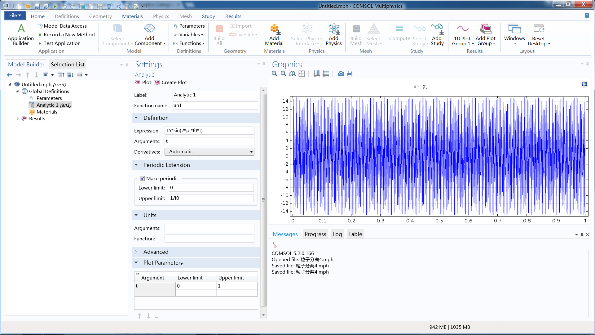

I 'm working on a project including piezoelectric transducer simulation.I have tried the way you suggested when applying a sine excitation with the frequency of 4.6MHz and the duration of 1 second. But what I got when I clicked the 'Plot' button was totally unexpected.
So how can I get a correct sine wave with the frequency of 4.6MHz in COMSOL?

I tried what you did, this is the first time I use the Analytic function (usually I use Waveform).
I think the problem comes from the used sampling frequency. If you try with different frequencies, it works at 1Hz, 10Hz. At 100Hz it starts to do anything, and at 1kHz it goes back to 1Hz.
Unfortunately, I do not know how to impose the sampling frequency. What you can do is setting the Upper limit of Argument t (in Plot Parameters) to a value small enough so that the result is correct.
Or you may use "Waveform" instead of "Analytic" when selecting the kind of Function (which is what I describe in my previous message).

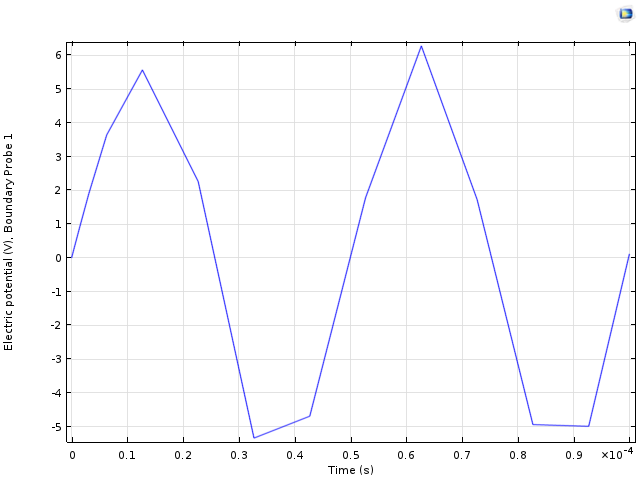

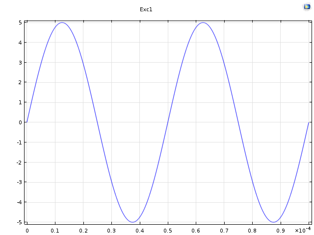

The first problem I would like to resolve is related to the voltage applied to the piezo. I apply a sine voltage (see "Function_V" attached), and when probing the voltage during the simulation, what I obtain is different (see "Probe_V" attached). Note that in the probe file, there are many points, even if it looks like there is only a few (when they draw straight lines, they are drawn with many points). If I compute it over a longer time, it is even worth (see "Probe_V2"). Here, figure have been obtained with a "spring foundation", but it stays the same with a roller or nothing. I just wonder if solving this problem could solve all the others.

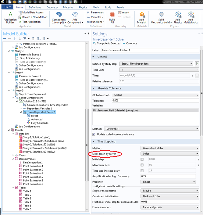

I think maybe you have to reduce your time-step increments because it seems they are too big and that creates the jumps in your Probe_V results you showed.
If that is the case you can in addition change the time stepping in the solver to "strict" or "intermediate"

Posted: 9 years ago Oct 24, 2016, 5:35 a.m. EDT
Hi Dara,
Thank you for your help, now Comsol applies the good voltage !

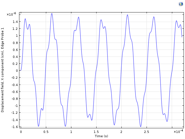

But I am afraid that it does not resolve all my problems, as the deformation of the piezo is not perfectly related to the voltage (see attached, using a probe to determine the displacement of a part of the disc). I will try to find if this is normal or not, and add something here (or ask some more questions).

First of all the structural analysis is not well defined without attaching the part with something to keep a "gauge" Z position. As you seem to only look for a radial contribution, it sort of works anyhow.
The waveform excitation is required for the voltage to get the sinus(2*pi*f0*t) shape.
I recommend always to do an eigenfrequency analysis to check the modes and you will see a radial mode at 193kHz, by plotting the mode participation factors and normalize the square of the MPF with the total mass you see which modes are the most "massive" to sort them by importance and direction. However in 2D axi you are already filtering many modes, be aware.
Then your time stepping seems for me quite reasonable, you get interactions with the higher modes because you apply a sudden acceleration and you excite many modes, as there is no damping in your model.
if you do a Fourier transform of your signal you will probably see the 193 kHz coming out, you might want an even shorter time stepping for that.
I would suggest to run an frequency domain sweep rather, start at your frequency f0 and a terminal voltage of 1 V and you will get a reasonable amplitude.
I always suggest to use intermediate time stepping mode when applying periodic load signal, as by default COMSOL is setting up the time stepping for non oscillating "diffusion" models, and might easily skip any periodic modulation. Anyhow periodic modulation implies normally a frequency sweep approach
Do not forget that COMSOL solves the true and full PDE of the physics such that all acoustic waves are also in there and when you hit a part with such a sinus step you excite many modes.
