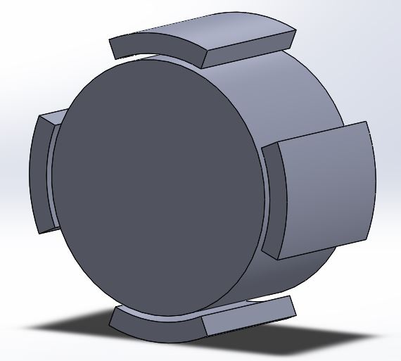

I am a beginner trying to use comsol. How am I supposed to model several magnets with alternating poles (North and South). Four magnets in a circular array. And then to find the magnetic force acting on an iron shaft that passes through (a linear motion) these four magnets.

For modeling a rotation, you might want to use the "Rotating Machinery, Magnetic" interface in AC/DC Module similar to the generator example below:
www.comsol.com/model/generator-in-2d-2122
In 3D, similar to the tutorial example:
www.comsol.com/model/rotating-machinery-3d-tutorial-10437
For radial or azimuthal magnetization and also for calculation of force/torque, the magnetic gear examples might be useful.
www.comsol.com/blogs/modeling-magnetic-gears-in-comsol-multiphysics/
