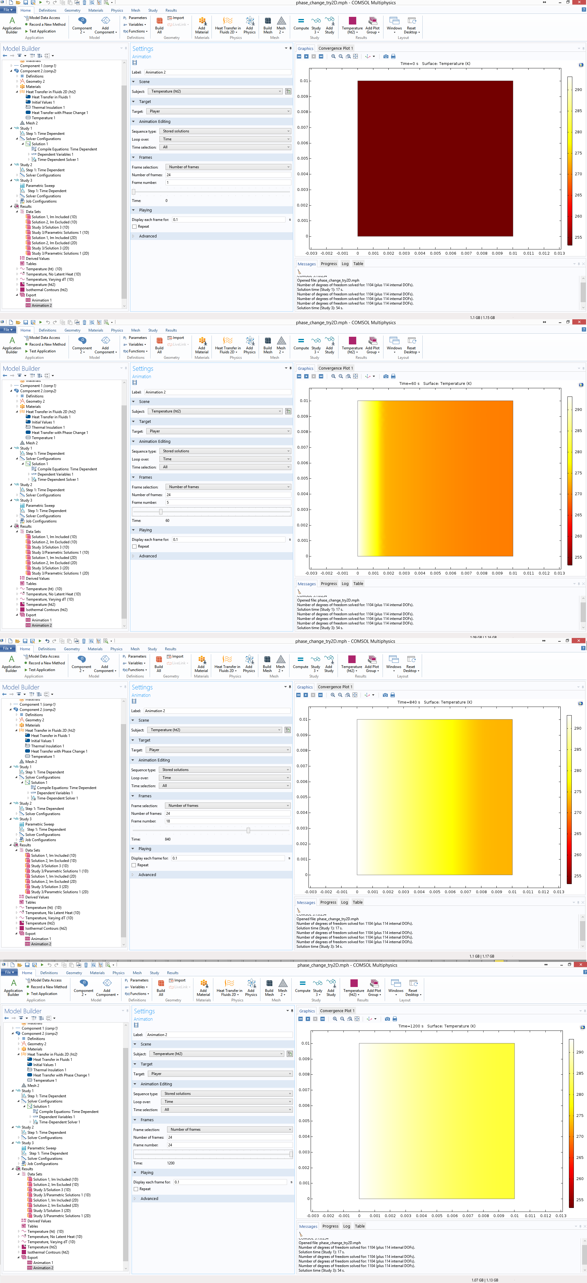

Looking through community answers and the Comsol examples. I wasnt able to find a 2D example of phase change. I decided then to take the 1D ice melting example ( www.comsol.com/model/phase-change-474 ) and completed all the steps again in 2D.
The attached file shows the temperature results.
Now I would like to add in gravity, such that the lower density material rises.
Could someone please point me in the right direction? Or point out any pitfalls?
Many thanks
Jesse
