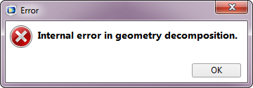

Internal Error in Geometry Composition
I need a list of ALL the reasons this error can pop up. I swear I just spent 70% of my day fighting the software to get a damn Boolean Union to work.
For my specific case, I create a workplane and in the workplane I create a path. I sweep the path, then extrude the swept area. Depending on which parts I actually extrude (lots of overlapping parts once a sweep is done), I can combine them or get a message telling me to go kick rocks.
It's totally inconsistent. I will change the dimensions slightly and re-do the sweep and extrusion, and now it doesn't like what I extruded. Doing a Union of just the swept faces or the extruded parts doesn't make a difference.
If I mix and match correctly, it can work out. Unfortunately I have absolutely no clue as to which ones are the correct ones. Even if I select the same named bodies as before, it isn't guaranteed to work.
Why isn't the message more helpful? The error has to happen *somewhere* in the geometry. Can't it just say "error on Domain 3" or whatever. At least then I could narrow it down instead of rolling some dice again.

The error message "Internal error in geometry decomposition" means that you have encountered a bug in the software, more or less. It is usually very difficult to say what entities in the geometry triggered the bug. We are constantly working on improving the Boolean operations, so it would be valuable if you could send your model to support@comsol.com. The support team could also give you best practices for avoiding the shortcomings in the Boolean operations.
