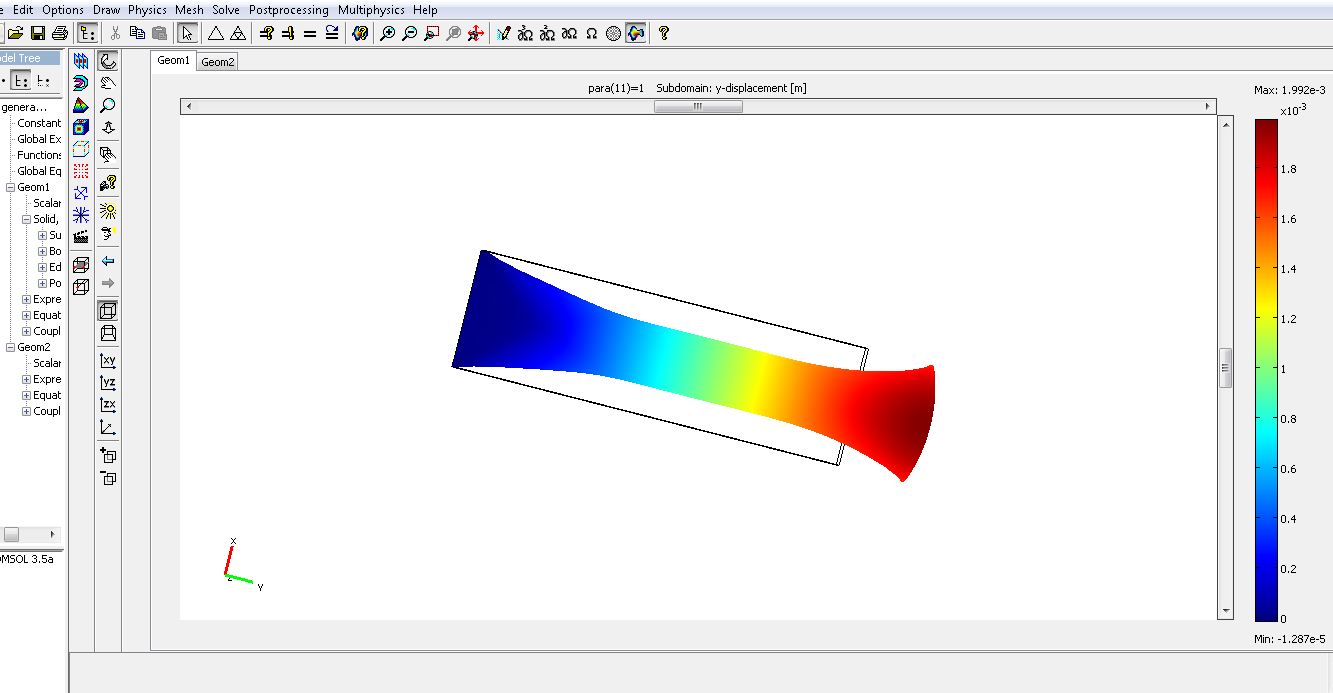

I'm trying to model the simple uniaxial tansion of a neo-hookean hyperelastic beam, and i have some problems about the bounday contrain.
I fixed an extremity and i impodes a ditribuited load at the othe end. The problem is this last end: infact i would like to constrain both ends of the strip, in a such way the loaded end can't deform in any direction.
I tried the roller and the axial simmetry constrain, and the prescribed displacement, but the problem remain.
In attach the fugure of the deformed shape of the beam. What can i do to prevent the deformation of the face in the load direction?
Thanks a lot for your help!
Sandra
