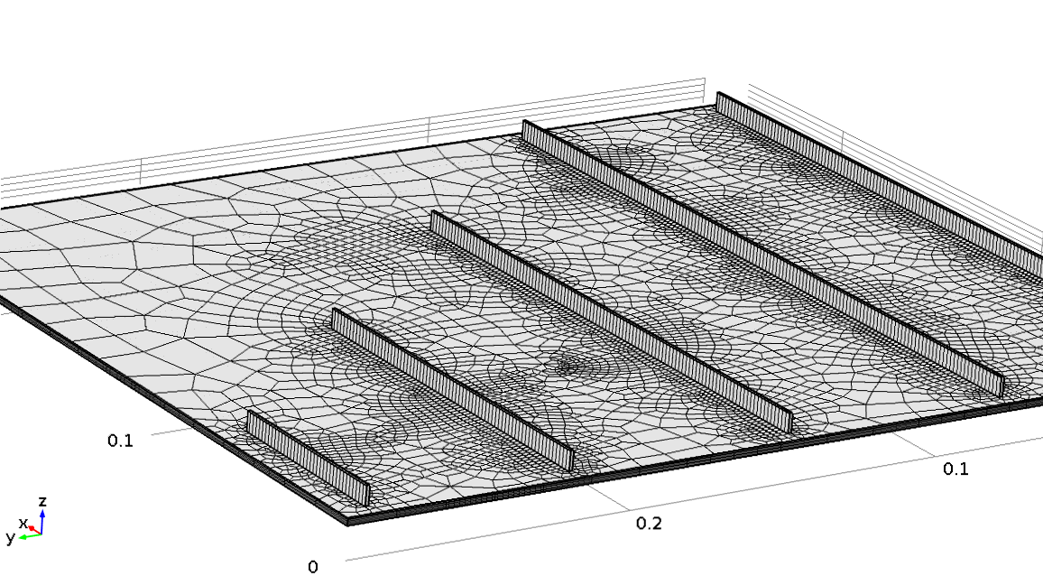

Hello all - I am modeling DC current through an electrode assembly. The goal of the simulation is to determine the uniformity of current density, then run a parametric sweep over the location and size of welds and terminal blocks. The electrode plates have a very high aspect ratio - 0.5mm thick x 250 mm wide, and some of the weld features are just 1-2 m. Without the ability to use shell or beam elements, the free mesh requires many, many elements. I would like to instead map the face of the electrodes and sweep through their thickness, but am having problems where the plates intersect the welds.
Can anyone recommend a way to sweep the mesh over the entire model, or sweep individual domains and knit them?
