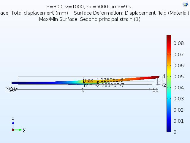

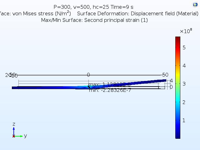

I am getting difficulty in measurement of bend angle for my model. can anyone suggest me how to measure the bend angle along z-axis. I can find the displacement in x,y,z axis using u,v,w but how to find the angle of surface or point with reference to y-axis. please find the attachment for more clarification. thank you all.

Initially, I considered the bend angle as tan inverse of dispplacement field in z direction to half length. but if you see from the image attached here the displacement of surface is much higher than what is showing as z-axis displacement.

Keep in mind that the distorted shape has a scale factor that is adjustable. It may LOOK like there is a big displacement when the displacement is really very small.
If the displacement IS large, make sure you have "include geometric nonlinearity" checked.
Finally: although "the answer lies in trigonometry"- it is not clear whether you want the angle at a particular point OR the average angle along the domain. If the first, you may want to use solid.nX, etc. evaluated at particular points.
