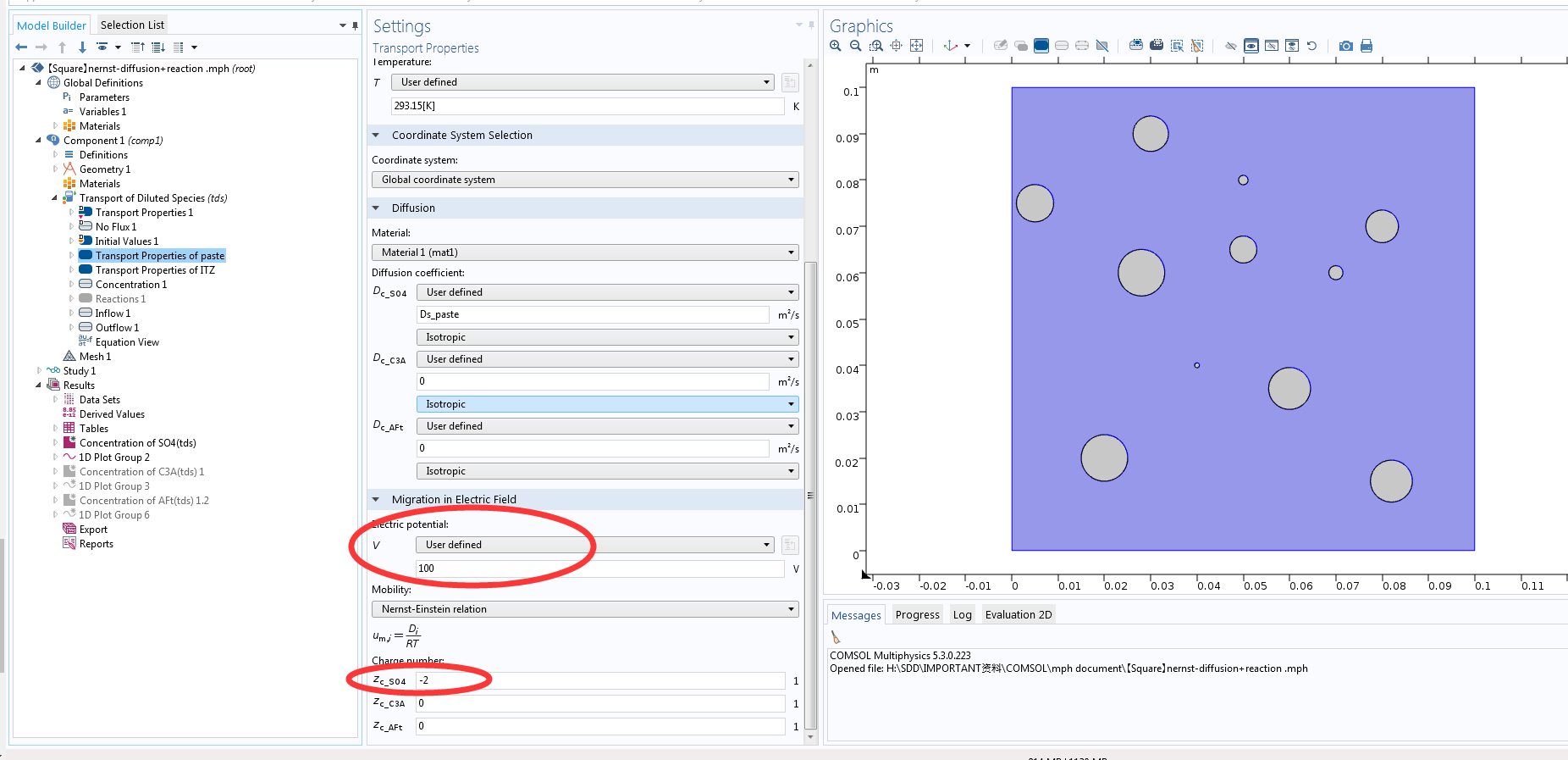

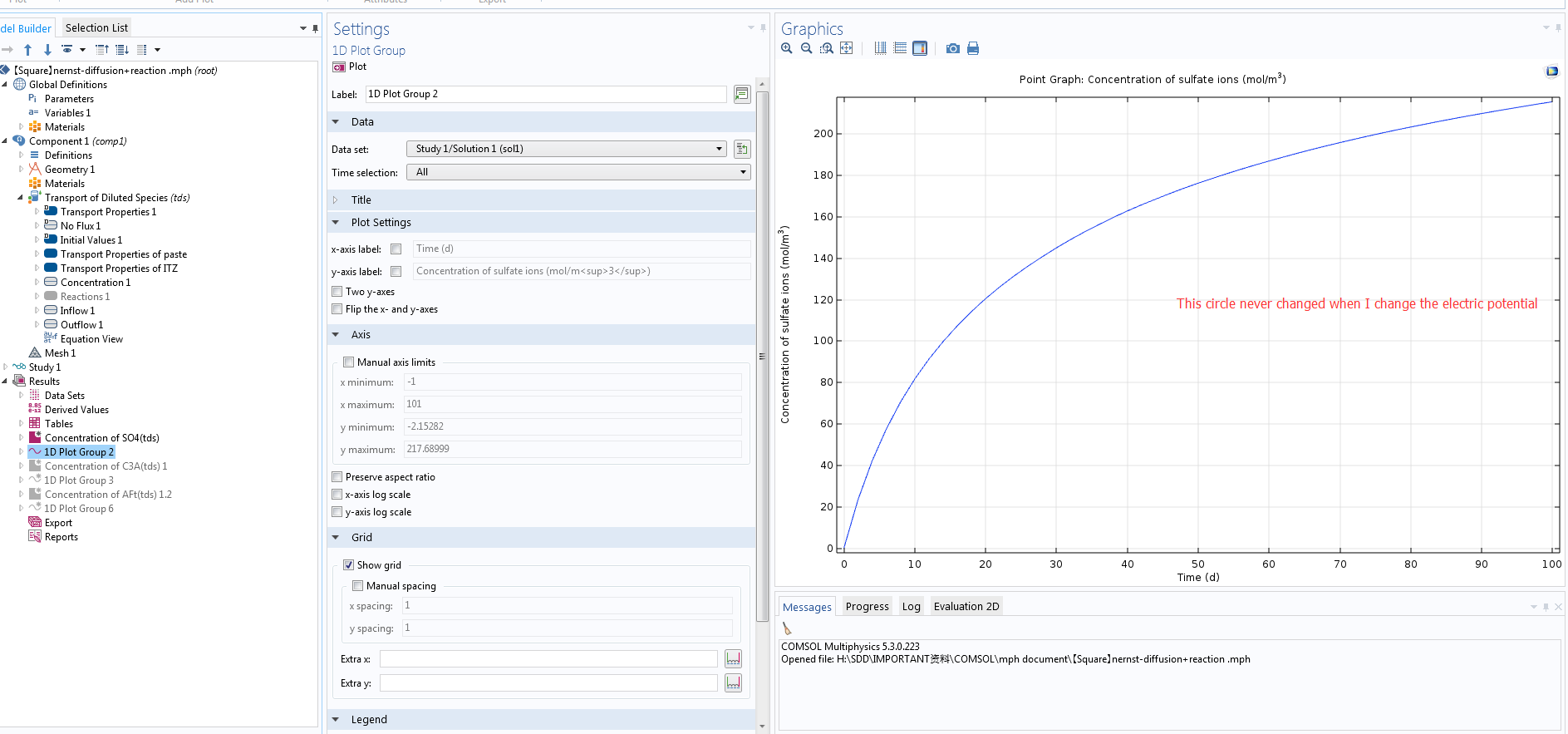

I'm trying to add the migration phenomenon in the physics of Transport of Diluted Species, so I click "Migration in electric field" under the Transport Mechanisms, and input electric potential and charge number. (What I want to simulate is the ions transport in concrete and the self-induced electrical field created by the movement of the ions). But the problems is that no matter how large the electric potential I input, such as 1V, 100V, the 1D Plot of ions' concentration never changed. So I don't know which step has mistakes.

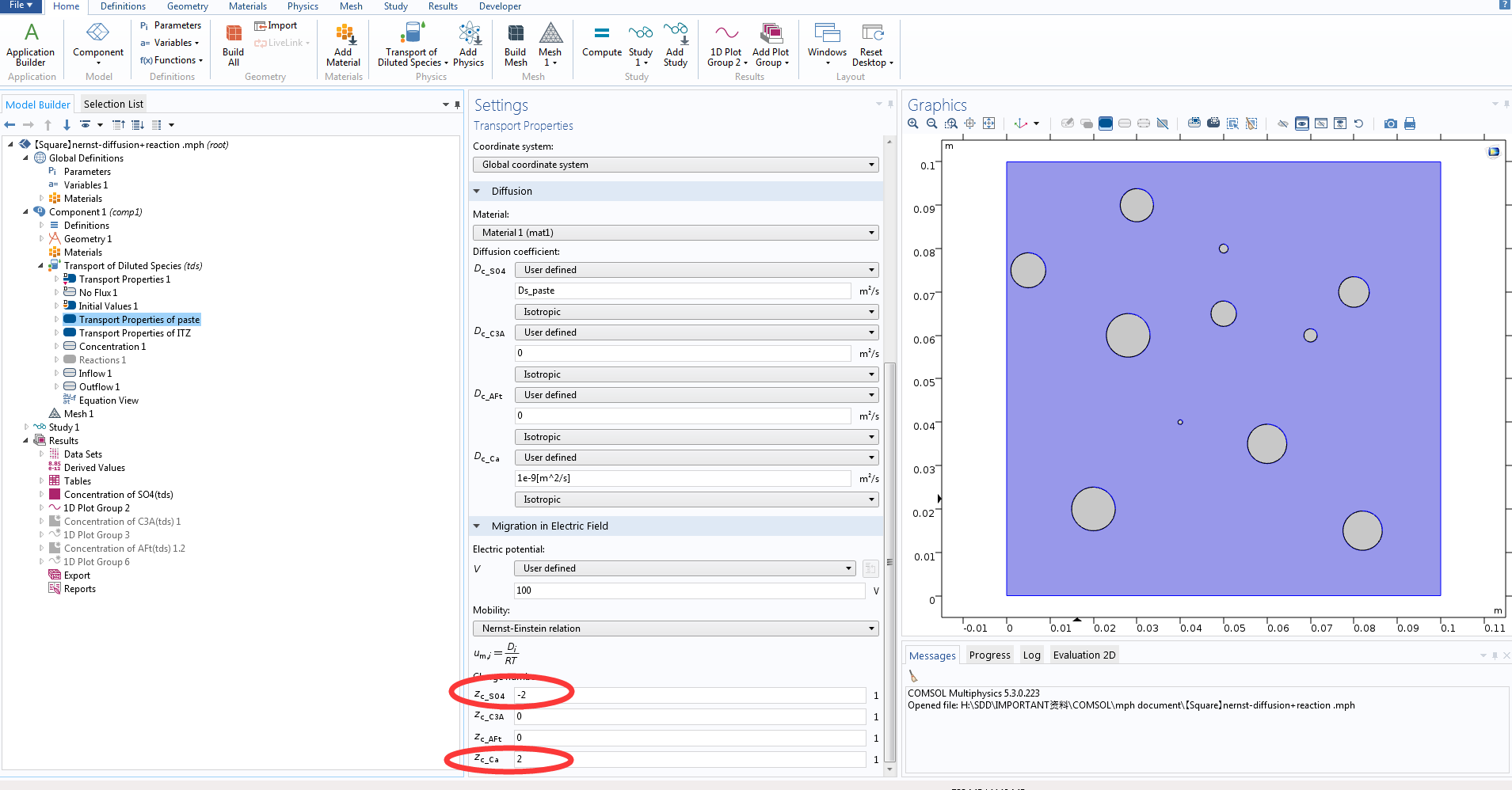

You have only one electroactive species, which violates electroneutrality. You must add another ion, a counter-ion, a cation in the system. This applies also when the other ion is not actually moving (steady-state).

Thanks for your answer. I've tried this method but it still doesn't work. The curve of the concentration never changed no matter how large the electric potential is.

A constant potential does not cause migration, an electric field is required.
Lasse
A constant potential does not cause migration, an electric field is required. Lasse

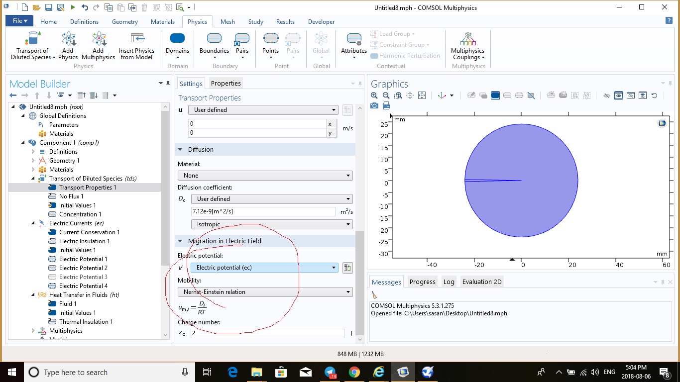

Hi, You should also activate electric currents module. furthurmore, in transport of diluted module, you should use electric potential instead of user defined option in section of Migration in electric field. you can also view the attachmant.
