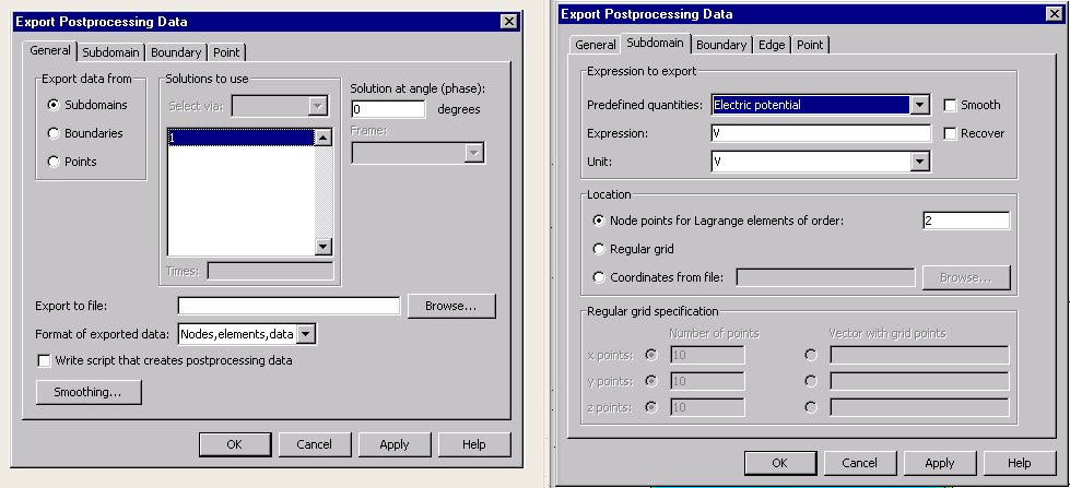

With version 3.5 I use file->export->post-processing data
then I use the format "Nodes,elements,data" and it works (see v3.5.jpg)

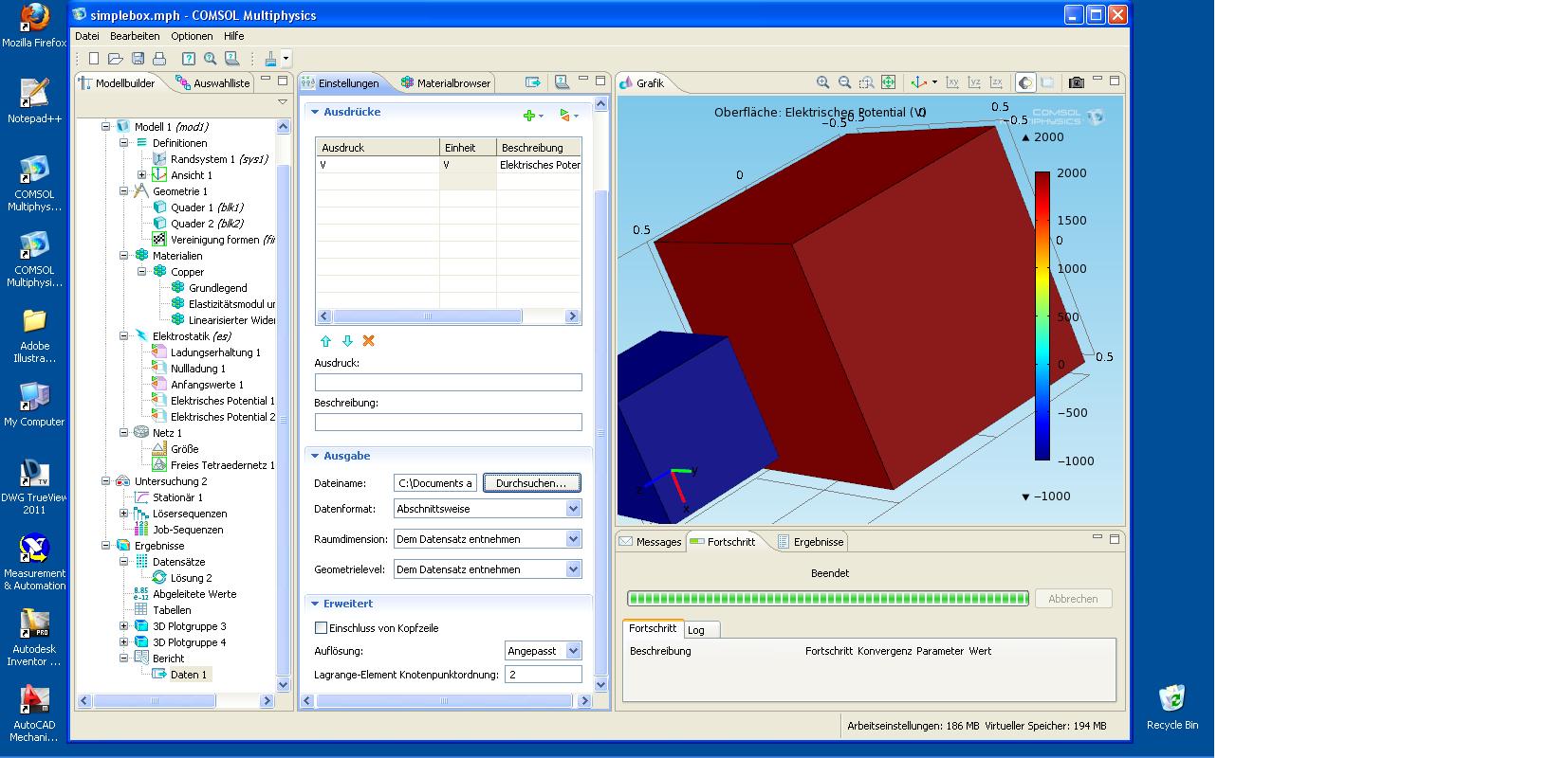

With version 4.0 i tried report(right-click)->data
then I choosed electric potential, format: sectionwise, switched of the header button and choosed for resolution: custum with lagrange-element node order 2 (see v4.0.jpg)
the output file looks almost the same, but when I try to import it with Garfield it says "Element 1 is degenerated".
