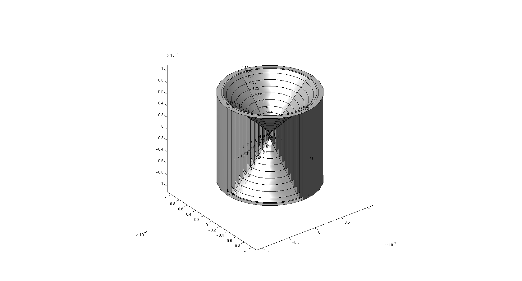

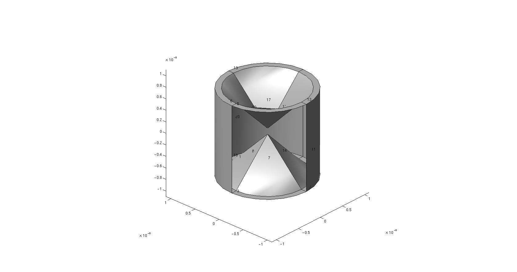

I'm simulating an electrostatic system in comsol+matlab 3.5a. My results shows large fluctuations when I change to geometry slightly, and I suspect that this has something to do with the meshing. Can anybody give me a hint of what to look into to minimize these fluctuations?
I have looked into meshsmooth(..) and meshrefine(..), but I have found that meshrefine(..) reduce the fluctuations but change the results qualitatively (to something qualitatively different from the analytical expr. it should approach). My geometry is cylindrical symmetric, so I think that the optimal would be to create a cylindrical symmetric mesh, however i cannot create this by revolving a 2D mesh because I have points on the revolving axis.
Help me! I'm in distress!
Thanks, Morten.
