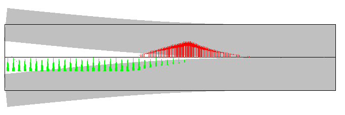

Hi Stefan,
I have uploaded a simple 2D model (version 4.3b) illustrating the principles of how a cohesive zone can be modeled in COMSOL Multiphysics. The model is not solved, but it only takes a minute or so to do it (and the animation during solving is nice).
Important features are:
- The expression in the thin elastic layer and the constitutive function it references.
- The extra weak expressions added for keeping track of the maximum opening experienced in a certain point. This is not necessary in a case where there is no unloading but then the constitutive relation would have to be written in a different (simpler) way too.
- The setup of the solver steps.
The uploaded plot shows the stress distribution (red) and a damage parameter (green).
The model is run under prescribed displacement. The reaction force plot shows why this is necessary. The released energy during cracking/delamination is so large that it would be unstable under a prescribed load.
Henrik

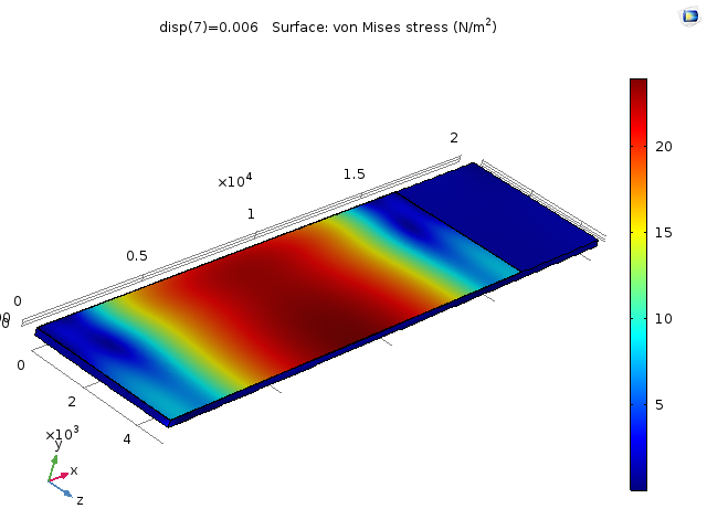

Hi Henrik,
Is there any other tutorials or more details about using the Thin Elastic Layer tool in modeling delamination. This will encourage more people interested in this type of problems to turn from Abaqus and Ansys to COMSOL. Currently there is no information.
Many thanks,
Peter
Hi Henrik, Is there any other tutorials or more details about using the Thin Elastic Layer tool in modeling delamination. This will encourage more people interested in this type of problems to turn from Abaqus and Ansys to COMSOL. Currently there is no information. Many thanks, Peter
Posted: 9 years ago Feb 25, 2016, 9:30 a.m. EST
Hi Peter,
There is a model in the Application Libraries, called "Mixed-Mode Debonding of a Laminated Composite". In the Application Gallery it is available as www.comsol.com/model/mixed-mode-debonding-of-a-laminated-composite-19961 .
More important however: In the next release, both Adhesion and Decohesion will be available as built-in functionality.
Henrik
