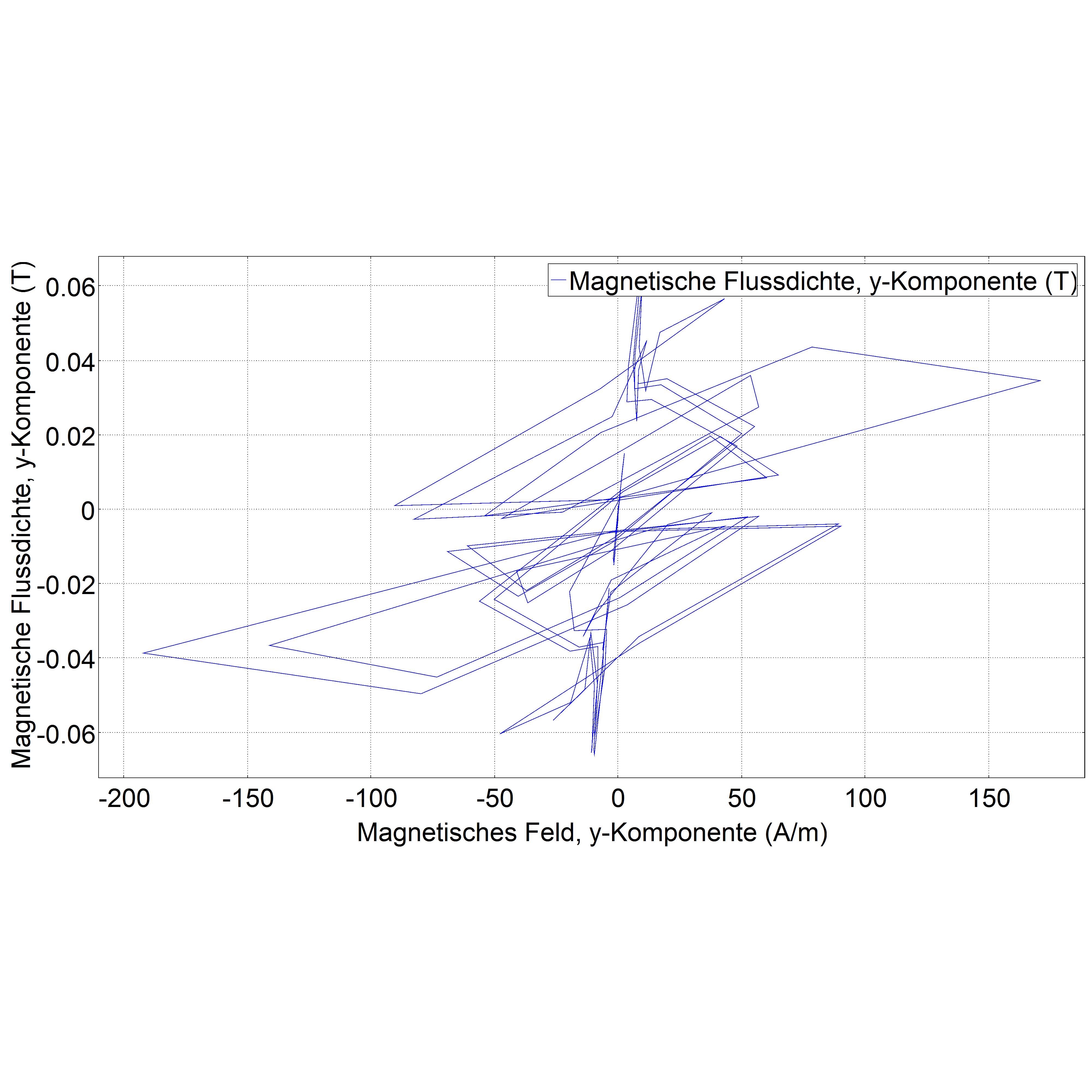

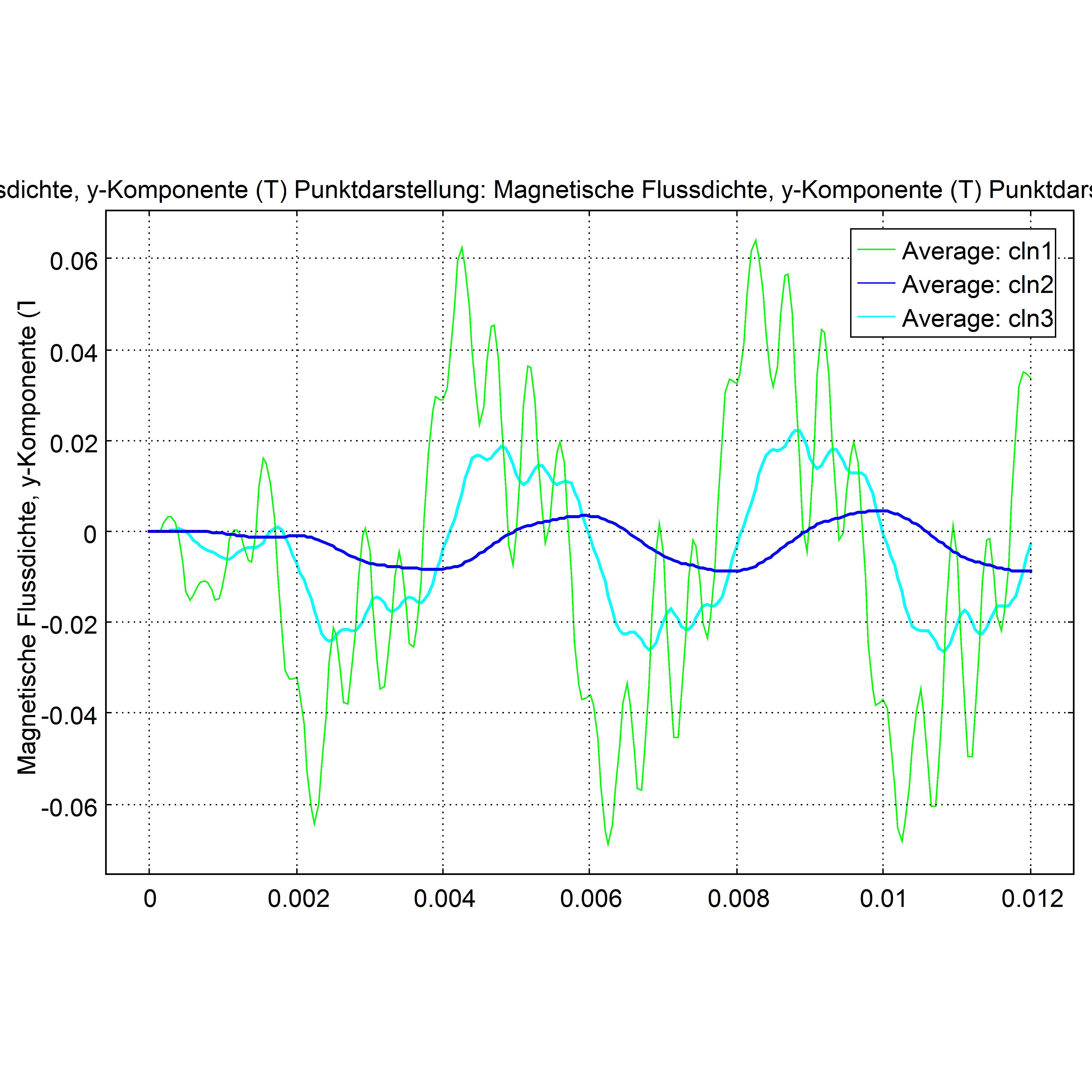

i desperately try to evaluating hysteresis loss in comsol way. there are a few commonly used formulas.
i think, the easiest is to measure the area enclosed by the hysteresis loop in a cycle Ahyst
Ph= f * integral [ H * dB ] --> but how about sekundare Loop ? see the attachment (hysteresis on the stator tooth)

i got the curve of one periode of magnetizing in B vs H.
The BH Area could be caculated in primitiv way. comsol has rmm.Wm calculated. by using photoshop i can evaluate the relation (c=Ahyst/Amax) between closed loop area and the maximal area of B*H (instead of rmm.Wm).
Whyst [J/m³] = c * Wmax
Physt [W]= Whys * freq * Volume
any comments are welcome.
regards
akmal
