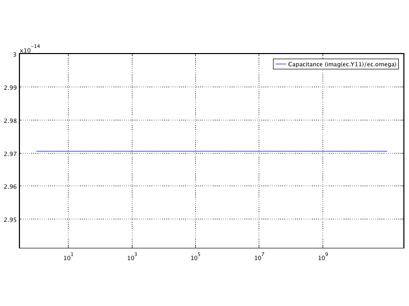

I was able to simulate my capacitor in a time-harmonic analysis in version v3.5a. Calculating the capacitance with the formula given in the microstrip example (C11=imag(Y11)/omega) gives me always the same capacitance, no matter what frequency I apply at the input port. I checked the input signal by drawing it versus the time, so I really see a sinusoidal signal with the desired frequency. This can't be correct, since the capacitance is frequency-dependent. Btw, I went up to 1 GHz.

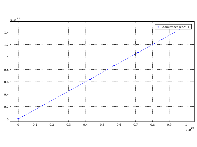

Then I tried a frequency domain analysis in v4.0a. Again, I simulated up to 1GHz and I calculated the Capacitance with the same formula. Again, I get a frequency-independent capacitance which can't be correct. I plotted the Admittance Y11 which shows a perfectly linear increase with the frequency, but I would expect something else due to fringing fields etc.
So to summarize: No matter if I try a DC analysis, a time-harmonic analysis or a frequency domain analysis, I always get the same capacitance, no matter which frequency I apply at the input port.

You're absolutely right, I also noticed that the Capacitance seems to stay very constant in lower frequencies but I guess this is just a question of resolution. I guess if you zoom in and adjust the axis scaling, the same plot would also show a quadratic increase in the lower frequency region, although its not that big. In my case, a have a perfectly constant value. Besides, I ran the simulation up to 100GHz yesterday and still did not see a difference.

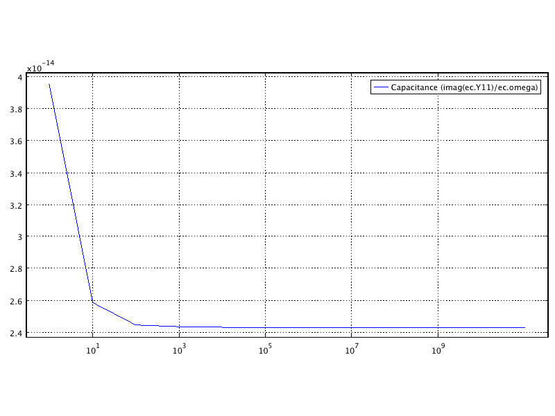

So I had the same idea and what I did was, I simulated the capacitor (14 microns high) on a 100um pyrex substrate (epsilonr=6.4) with another 100um air box on top (epsilonr=1).
The result is almost the opposite from what I would expect, the capacitance gets smaller (see attachment). The frequency range was from 1Hz to 100GHz by going up with a factor of ten (1Hz, 10Hz, 100Hz, ...).
Pretty strange...
of course COMSOL calculates the stray field (you call it fringing field). The difference between an analytical calculation and COMSOL is that COMSOL cannot calculate the stray field at large distances because the FE model must be finite.
In the AC/DC approximation the field topology does not depend on frequency, also the stray fields are frequency independent.
It is the nature of the quasistatic approximation that the relation of structural dimensions and wavelength are ignored.
You must probably use RF to see those effects you are expecting.
